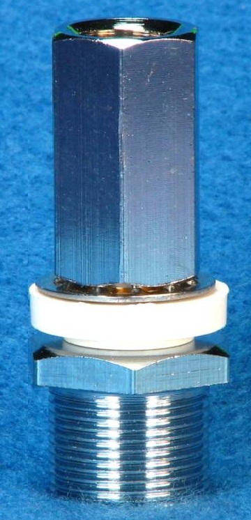

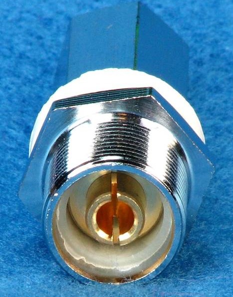

I read through stuff Bob has written about making VHF antennas. Here's how I understand it.
Coaxial cable has a center conductor and outer shield. The connector at the end of the cable connects the shield to the shell of this female connector, which gets screwed onto the male threaded barrel of the antenna mount. This part of the antenna mount is connected to the metal skin, which forms the ground plane.
The inner conductor wire connects to the inner conductor of the antenna mount, which is isolated from the surrounding male threaded barrel and hex portion that mounts inside the aircraft. The inner conductor of the mount is electrically connected to the 3/8" male threaded stud, which is also connected to the adapter, bolt, and antenna whisker.
To install this ebay mount, it looks like I'd remove the 3/8" female threaded hex barrel adapter, star washer, and what looks like an insulating shoulder washer. From the inside of the aircraft, insert the 3/8" male stud through the doubler and skin, then slide the shoulder washer and star washer on from the outside. Tighten the hex barrel adapter over the stud, then the bolt/antenna whisker.
If I've understood it correctly, there wouldn't then be an issue with lock-washer centering, which I didn't understand in the first place.

PostPosted: Fri Nov 11, 2011 5:55 pm    Post subject: antenna connections Reply with quote
There's an article on the materials and process at:
http://aeroelectric.com/articles/Antennas/DIY_Comm_Ant/DIY_Comm.html
I modify the adapter in a lathe to provide
a centering shoulder for the lock-washer.

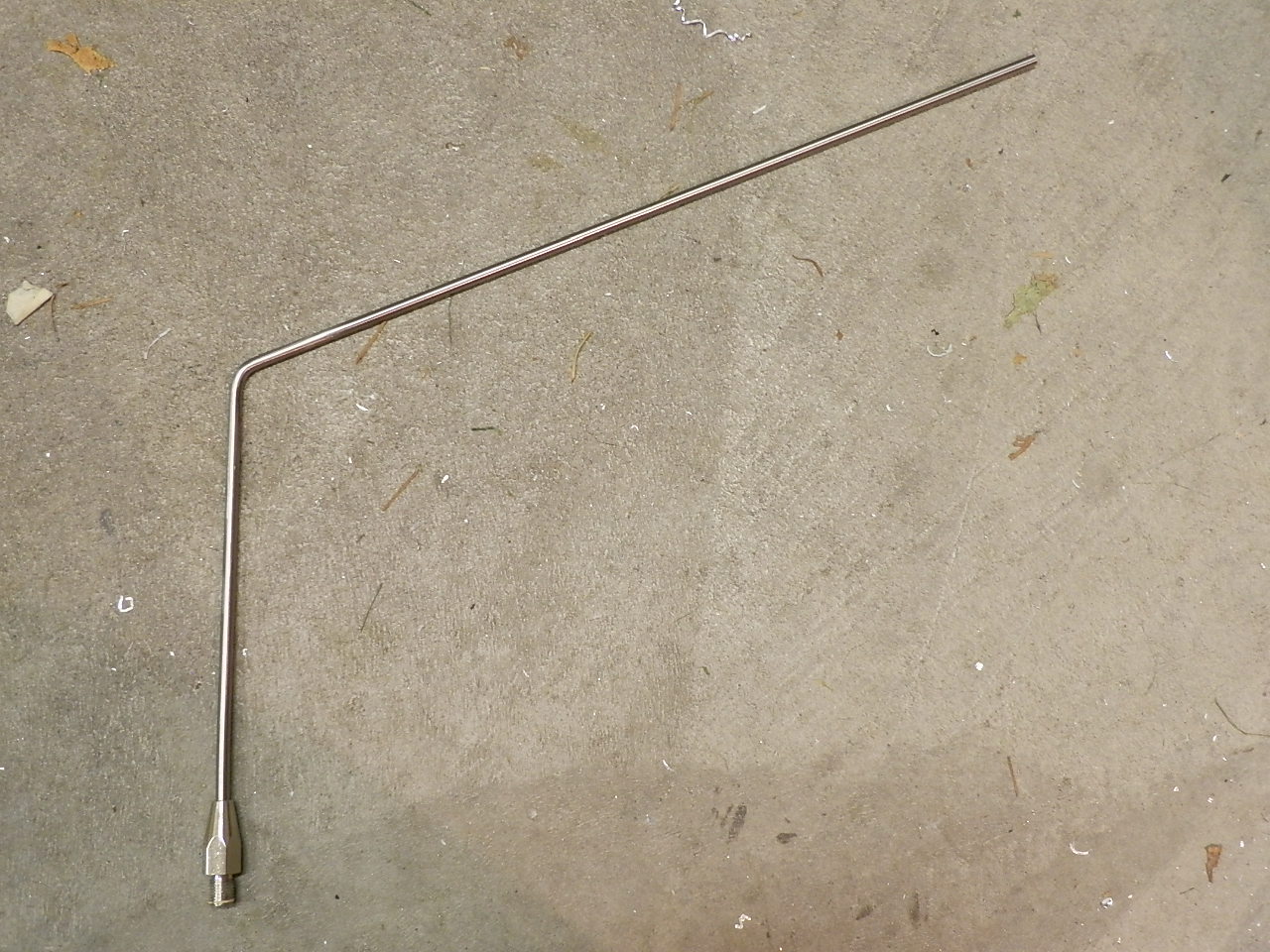

Got the RS antenna. My only initial anal concern was the weight at .20" diameter at the 22" mark. It tapered down to less than 1/8", but that was near the end of the original 120". I've seen some com antennas listed as 0.15" thick, so I gained 1.5 oz.
I bent it at ~8" to about 40 degrees after heating it with a propane/air torch. Used a little $10 HF tubing bender. It wanted to also put another bend real close to the base, but the bender config would have made that real tough, so I increased the bend to 68 degrees at the original location.
I ran a scotchbrite roloc over it to get the discoloration out, which was fairly easy to do. Will this area be as stain resistant as the other areas? When I got my EGT probes, the bayonets were welded to hose clamps. Around the welded area there was rust.
Clearance under my Sonex TD is ~19" at the planned location of the antenna. Vertical for the antenna is ~13", giving me 6" ground clearance. I also just bought that base connector off eBay.
This has been the type of project I really like. Doing something simple and saving money. $22 for the antenna, $5 for the mount, $2 for the BNC-UHF adapter at Frys. That compares to over $65 just for the antenna at ACS, which still needs more bending to go on the belly. Thanks, Bob!

PostPosted: Tue Nov 15, 2011 8:36 am    Post subject: antenna connections Reply with quote
At 11:08 PM 11/14/2011, you wrote:
K.
Yup, that's called sifting through the options and
evaluating the trade-offs. But it IS a robust antenna.
This brings up another point. That antenna is not
very compliant . . . I.e. it's stiff. Make sure you've
got a robust doubler on the belly surface.
Sounds like a reasonable trade off . . .
Heating a material to a ductile state does not change
it's alloy. If it was 'stainless' to begin with, it's
still stainless.
belly. Thanks, Bob!

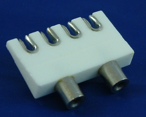

WAAAAAyyyy back when, some premium electronics device
like Tektronix scopes used terminal strips that were
ceramic moldings with a sliver alloy bonded into
the notches like this:
[img]cid:.0[/img]
These were popular with other high-end product of the
vacuum tube era. One was well advised to use a silver
bearing solder to make up joints on these terminals
to avoid "washing" the sliver off the ceramic and
breaking the bond. Many a 'scope I've opened from
that era had a small quantity of suitable solder
stashed somewhere inside by the factory.
This sort of solder would be useful in making up
joints on any silver-plated terminal.

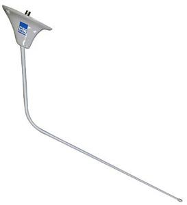

Yeah, that sounds familiar about aluminum. On the other hand, I've found some antennas made out of aluminum.
The DM C63-Series antennas are VHF communication antennas designed for high mechanical strength with machine tapered aluminum alloy radiating elements.
http://www.aircraftspruce.com/catalog/avpages/c63_2.php
Is there anything different about this type of antenna compared to the one I'd suggested, outside of a streamlined base?
