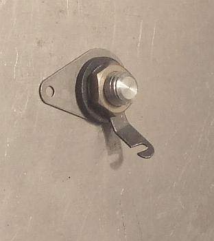

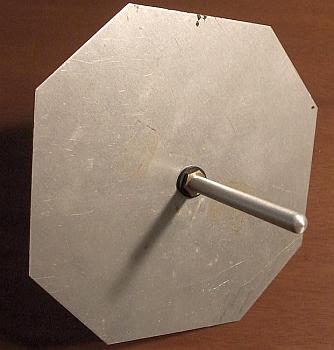

Here's two pictures of the front and back of it that I just took a few minutes ago (I assembled it...the small parts all came in a small plastic bag...the ground plane was separate):
[img]cid:part1.09010702.04080703(at)agelesswings.com[/img][img]cid:part2.05080503.04060901(at)agelesswings.com[/img]

Actually, the pictures will suffice.
Now you've got me wondering. If it was not from RST, then I have no idea where else I would have got that aluminum antenna from...it was on a shelf at my hangar with the parts that I did get from RST that I didn't use (nav antenna and some BNC connectors and cable)...and the octagon ground plane was with it. BTW...now that I've had it in my hand, the grommet is fiber, not rubber.
Yeah, that makes sense. It needs to be mechanically
rigid.
I'll send the ground plane along with it...where do you want me to send them?
I published a similar configuration in the 'Connection way
back when. It would be interesting to know who made it.
In any case, the pictures are great. I'll probably add them
to the photo album on the website.
