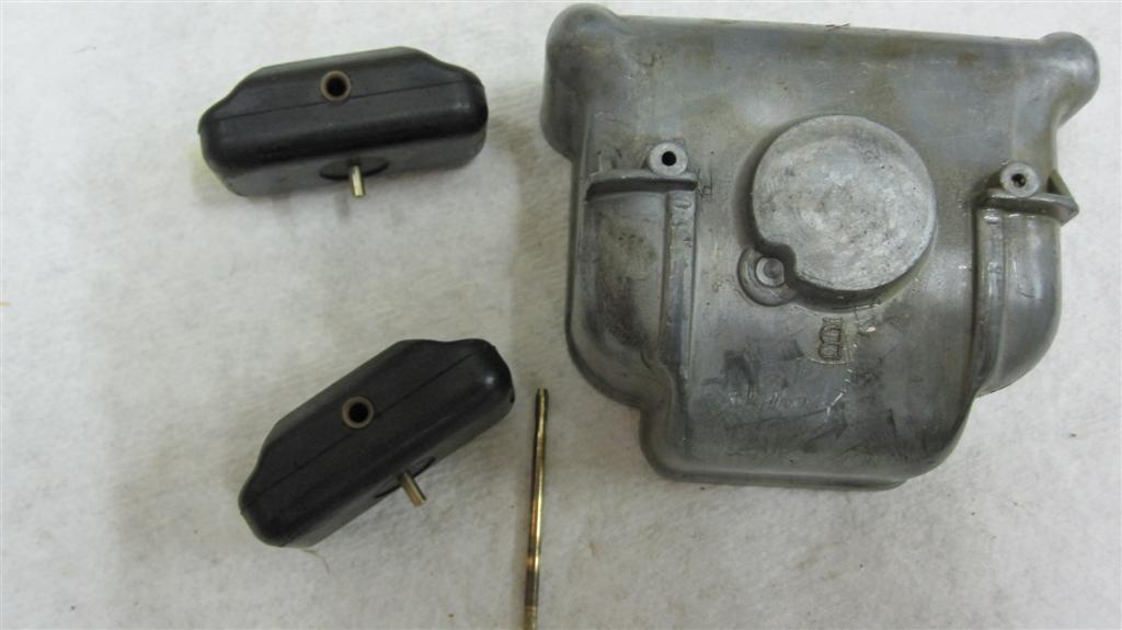

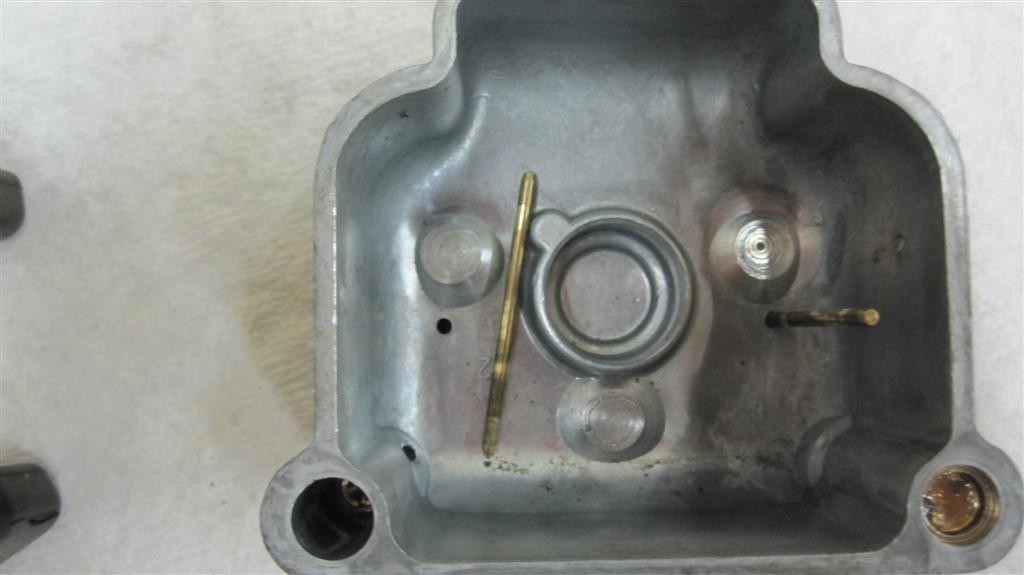

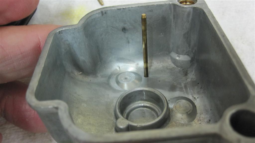

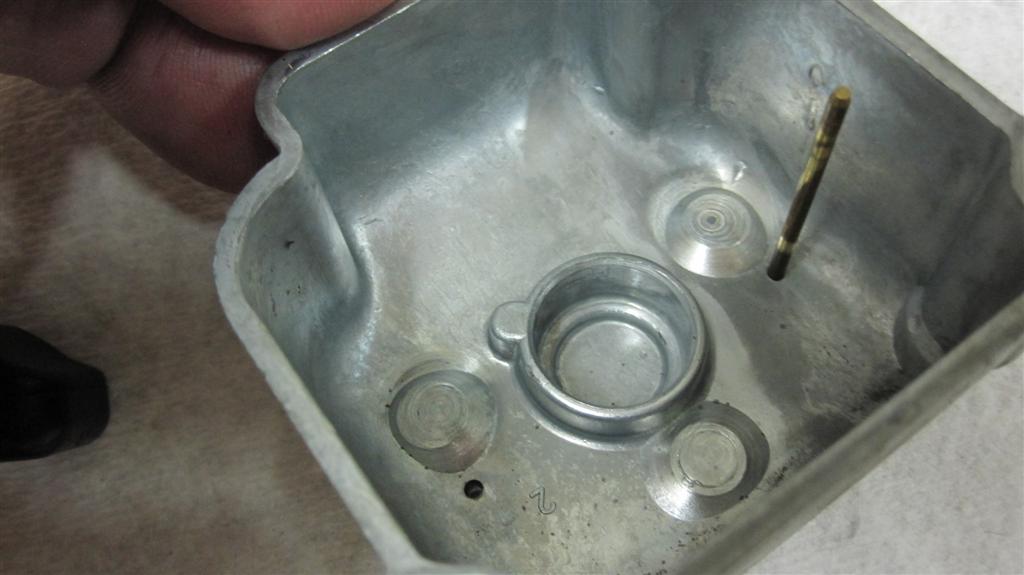

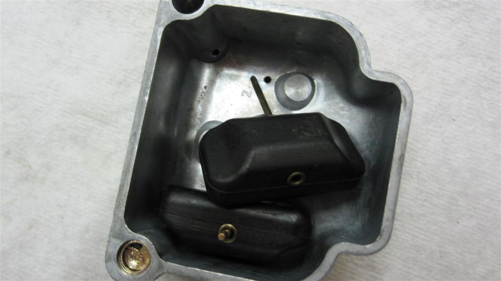

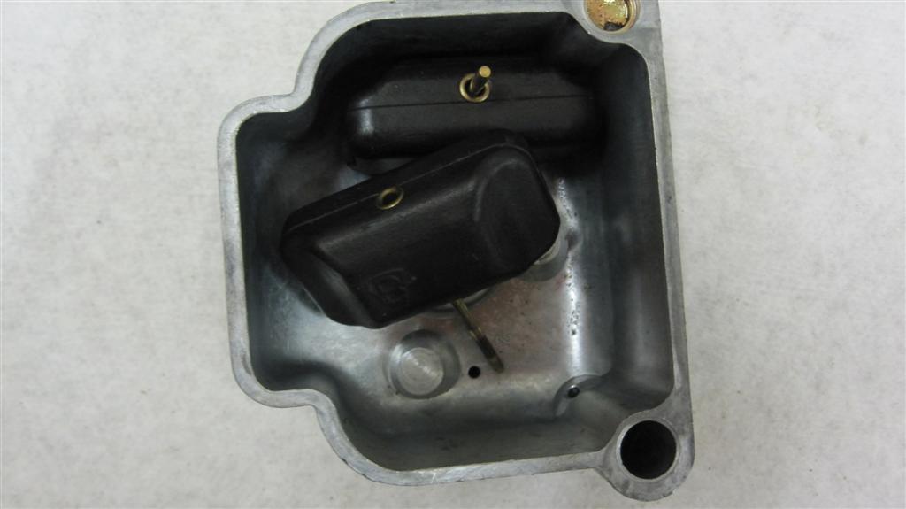

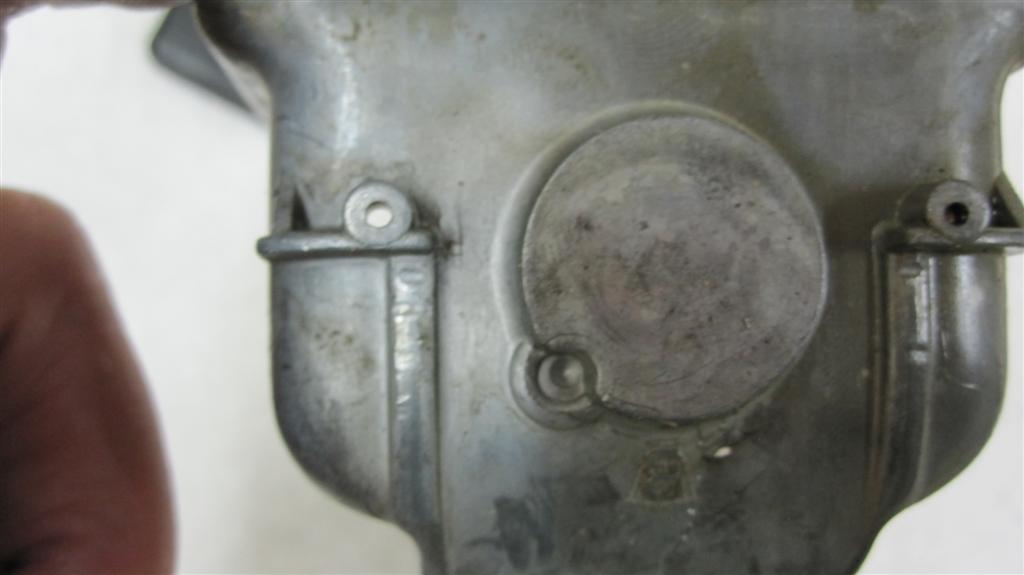

Happened yesterday, RANS S-7, pilot landed, put the airplane away, went inside. Came back 2 hours later, 2 or 3 gallons of gas on the floor.
One of the float pins came out and the gas ran out the bottom of the float bowl. Engine is a 912ULS, serial # is 5648894, carb serial # is 072585, this engine has approx 150 hours.
The pin is not knurled, it is just pressed into the bottom of the float bowl. Since a lot of the people on this list use the 912, thought it would be of interest.

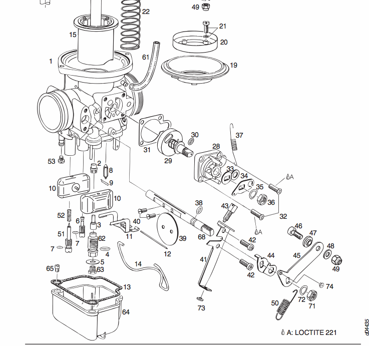

Thanks for the heads up, Richard. Of all the Bing 64 and 94 carbs I've taken apart I've never seen any indication that these pins were in any way loose. There is another pin, which acts as a hinge pin for the floats, that goes through the light gage ss part(11) that the float bears on. This other pin is knurled on one end so that it stays seated firmly in the cast metal part of the carb body. The pin I am referring to is labeled 12 in the attached image.
It appears that the pin that fell out of one of the floats in your photo was due to a manufacturing defect. The float (item 10 in attached image) comes with these pins permanently installed, or so they should be.

PostPosted: Fri Oct 28, 2011 7:35 pm    Post subject: Bing Carb Failure Reply with quote
You are correct, the two stroke is the same design, the float pivot pin
cannot come out as long as the float bowl is in place. But this is a totally
different pin, and it is not knurled, it is tapered where it goes into the
float bowl. I concur with Thom's assessment that this was a bad part. On the
other hand, it would be something easy to check, by dropping the float bowl
and giving it the wiggle test.

There are pictures attached to this report. Look at them if you get a chance. From looking at the pictures the guide pins, are inserted into holes that are drilled all the way through the float bowl. When the pin falls out, there is just a hole in the bottom of the float bowl for the fuel to drip out.

PostPosted: Sat Oct 29, 2011 5:44 pm    Post subject: Bing Carb Failure Reply with quote
to drip out.

PostPosted: Sun Oct 30, 2011 7:26 am    Post subject: Re: Bing Carb Failure Reply with quote
I am talking about Richards report of the incident right here in this very thread you are posting in. I realize that some people might not have access to the pictures or might not bother to look at them. But if you do, it clears up all confusion about what pin it is and the fact that when the pin comes out there is just a hole in the bottom of the float bowl.

PostPosted: Sun Oct 30, 2011 2:10 pm    Post subject: Re: Bing Carb Failure Reply with quote
Got this update this morning from Dean Vogel at Lockwood Aviation:
"We have seen that issue with the float bowls before. I have – for a while now – included the checking of that detail in the Maintenance training class when we go through the carburetors. The only solution is to replace the float bowl."
On the other hand, since this is East Tennessee, and we do things our own way - the owner reamed the hole a hair larger, packed it with JB Weld, and drove the pin in FIRMLY.
Will keep ya posted...
