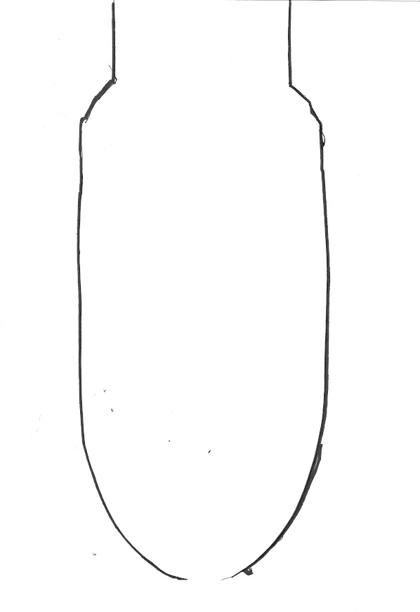

Phil(at)ReliantAir.com
PostPosted: Tue Oct 18, 2011 5:13 am    Post subject: Cowl Install Reply with quote
Gary thanks for the info. I know I saw that template in my email at one time, can’t find it now. Could you resend it to me?
Phil

teamgrumman(at)yahoo.com
PostPosted: Tue Oct 18, 2011 7:35 pm    Post subject: Cowl Install Reply with quote
Phil,
Sure, no problem.
Here is the template.
