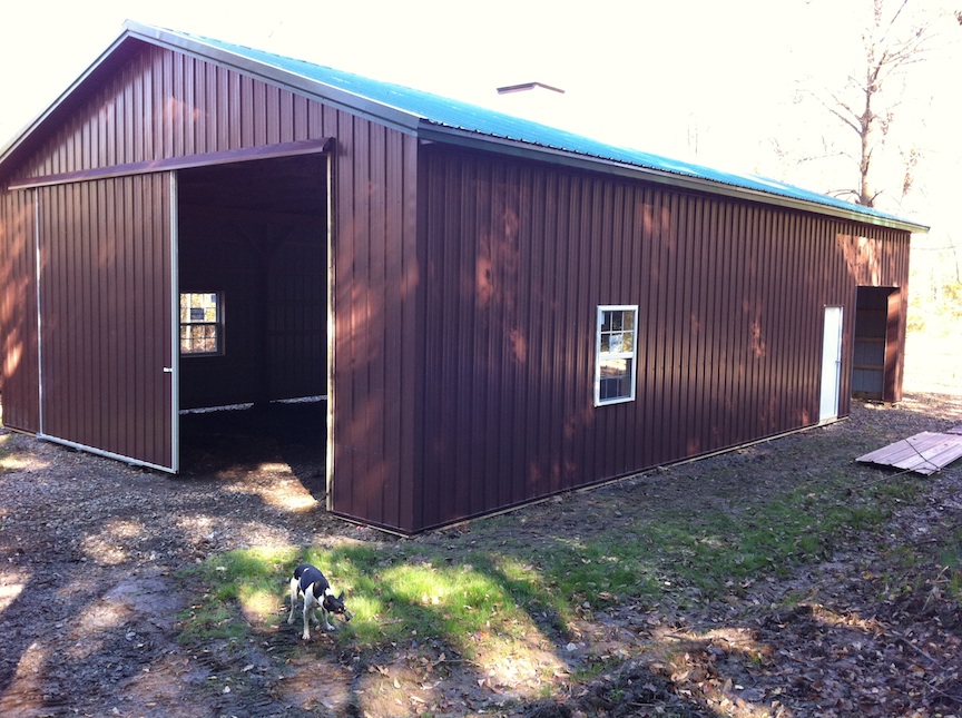

This summer weather in October was waaay too good not to fly, so I flew to Bob Bean's place and landed on his "mature grass" airstrip. No Brakes Required!
Enroute, I stuck my hand back under the rear seat and felt a light breeze, nothing like I think the wide body Kolbs get. It was a little cool to have my forward vents open so this slight breeze was with a bit of negative cabin pressure (presumably) because the aft vents were open in exhaust mode. By the time I got close to BB's place it was warm enough to open the forward vents, which I did. With this bit of positive pressure, I stuck my hand back under the rear seat and the air felt completely static to me.
My conclusion is that in MY slingshot, the breezy boom tube phenomenon is minimal and then only without forward vents open. Other Kolb types or even other slingshots may have a different experience.
After landing at BB's he gave me the grand tour of his brand new pole barn, just finished yesterday except for the garage door. Then we cranked up both the Kolbs and flew about 10 miles NW of his place to have lunch at Abe's Log Cabin restaurant, a very short walk from a very nice two runway grass airstrip, called Ridge Road West. After lunch we departed on our separate ways.
What a glorious October day for flying it was here in western New York.
