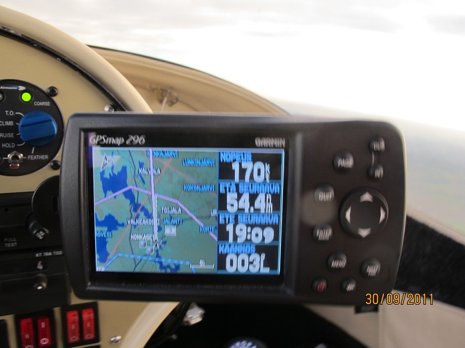

Yesterday I took off from a very remote /small /windy (90 degrees 12 knots and gusting MUCH) grass strip. Soon until well over the ground at altitude +500 feet with full power and 2nd fuel pump still on and gears up I felt suddenly let us say medium or more shake and vibration. My immediate reaction was to go around and land immediately but abandoned because wind was so furious and I felt I cannot do that (a succesful landing).
I decided to try to fly to the next possible sensible airfield EFHV which was 10 minutes apart.
Those minutes were long: I put my prob (Airmaster CS) to manual and drived it from fine to coarse, tried all the power settings and also a 2nd fuel filter. Finally I noticed that when prop was in a climb mode (in my case 5400 rpm /Rotax 912S) and MAP around 20 inches I got quite a comfortable flying mode and I headed straight home. My airspeed was w that selection about 110 knots but because of a strong headwind GS was only about 70 knots (wanted to be clearly over the ground at 3000 ft because it was well over sunset and totally dark, yesterday we got sunset around 1600 Zulutime and time was well over 1630 when flying).
So, I pushed home one looooong hour. All the aerodynamics were well. I was a bit worried my engine will separate or so. When trying to push more pwr it was more vibra and when trying to pull less pwr same. I Followed a main highway and decided to land there if feeling so. Cars there with lights are almost like a lighted runway...
