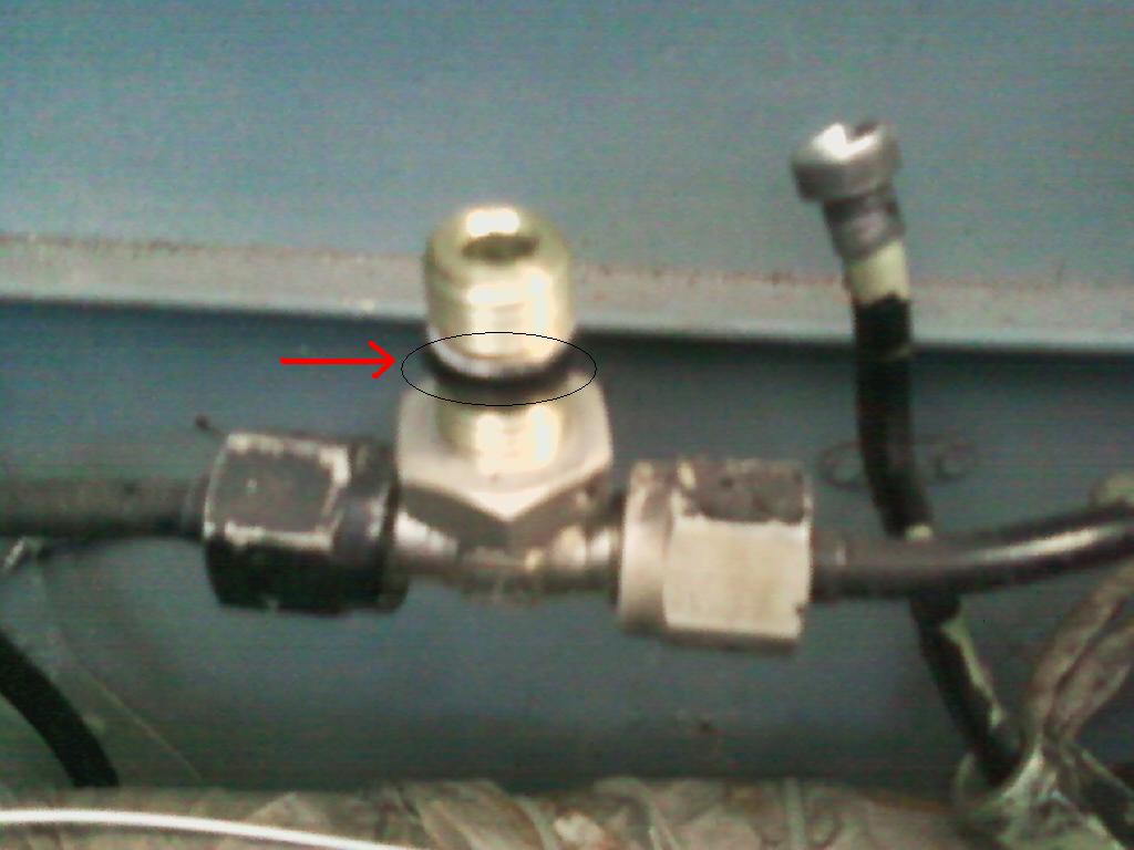

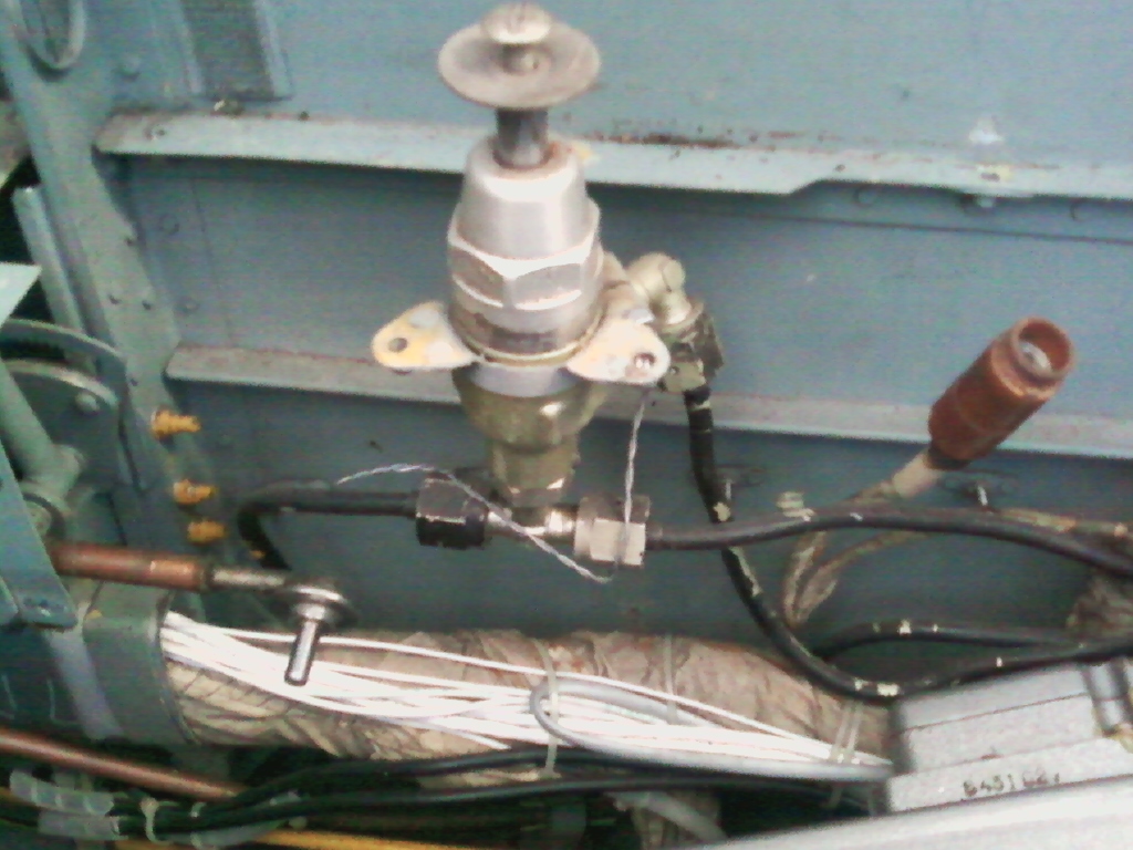

First, ultrasonic leak detector....priceless, found the leak in under 5 min.
The leak is where the t-piece fitting joins the bottom of the emergency valve in front cockpit. (see pic). I tried tightening the nut but found it would leak if I tried tightening it too much. I thought either the t-fitting might be cracked or the housing of the valve cracked. So, I took the
t-piece out and found the rubber washer cracked and dry. So, I'm pretty sure that is the source. Housing looks fine, t-fitting not cracked either.
Where do I get new washer? For that matter, probably will get two. Also, I trashed some of the screws that hold the top cover plate down to the inside of the plane, so need more of those as well. Thanks, Bill

PostPosted: Mon Sep 19, 2011 1:00 pm    Post subject: Emergency Air Leak update Reply with quote
Bill,Change it out for a CJ6 main air valve with SS needle, they don't have any rubber gaskets to go bad and I think (from your photo) it will be a pretty much plug and play operation.  I'd like to know myself so I'm willing to send you one to see if it will fit.  If it fits, pay me, if not send it back.

Doug, not sure I understand. Wouldn't the t-piece still need to be attached to the valve in the same manner?
dougsappllc(at)gmail.com
PostPosted: Mon Sep 19, 2011 2:49 pm    Post subject: Emergency Air Leak update Reply with quote
Bill,The T fitting is flare, flare, pipe thread.  The pipe thread leg threads into the bottom of the valve, no rubber parts needed to seal.  I'll try to send you a picture, save a thousand words...........

Try Jill at M14P. She may have the rubber washer in stock. As for the
screws, they are standard 4 mm screws. I'd suggest replacing them with
4 mm button head Philips screws. Can be either SS or zinc plated.

Thanks Dennis. Do you think a properly fitting o-ring will work?
Doug, from the picture, I don't think the CJ valve will work for me. The top elbow fitting looks like it points directly down over the bottom fitting. My top elbow fitting is directed backwards away from bottom fitting. Don't think there is enough play in the tubing to attach it.

PostPosted: Mon Sep 19, 2011 4:42 pm    Post subject: Emergency Air Leak update Reply with quote
I would certainly try a metric o-ring. Size it to the original if possible.

Thanks, I'll give it a try tomorrow. Let you know.

PostPosted: Tue Sep 20, 2011 2:58 pm    Post subject: Emergency Air Leak update Reply with quote
I haven't read all this posting but my valve was leaking. NAPA for the closest "o" ring size very fine sand paper, very fine. Put the o ring on a stick spin the stick and sand it till it fits. Haven't leaked since. If this isn't the correct problem, sorry. I'll read further next time.

PostPosted: Tue Sep 20, 2011 4:50 pm    Post subject: Re: Emergency Air Leak update Reply with quote
Problem solved. Went to ACE hardware store and bought 3 different sizes of o-rings. Went to hangar and found the one that fit the best. Pressure tested to 5 atm, no leak. Went for flight and re-check, seems good to go.

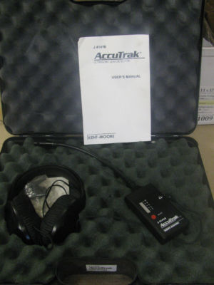

k7wx
Joined: 24 May 2010
Posts: 117
PostPosted: Wed Sep 21, 2011 4:33 pm    Post subject: Emergency Air Leak update Reply with quote
Rich,
Look for a used Kent Moore J-41416 Accutrak Ultrasonic Leak Detector. Relatively inexpensive and will end up an indispensable item for chasing pneumatic system problems. They are often listed on eBay.
Here is a picture.
PostPosted: Wed Sep 21, 2011 4:58 pm    Post subject: Emergency Air Leak update Reply with quote
Guys, what ever make of ultrasonic leak detector you buy make sure it has a set of head phones.  I bought a Amprobe off Ebay-- $150.00 as I recall, but that was 10 years ago.  It works well for me.
