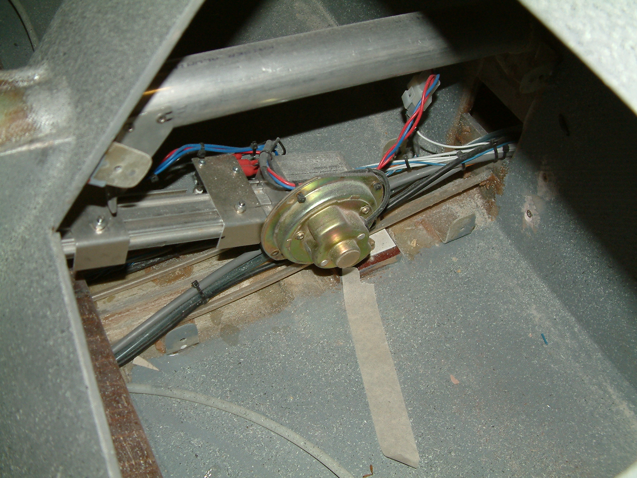

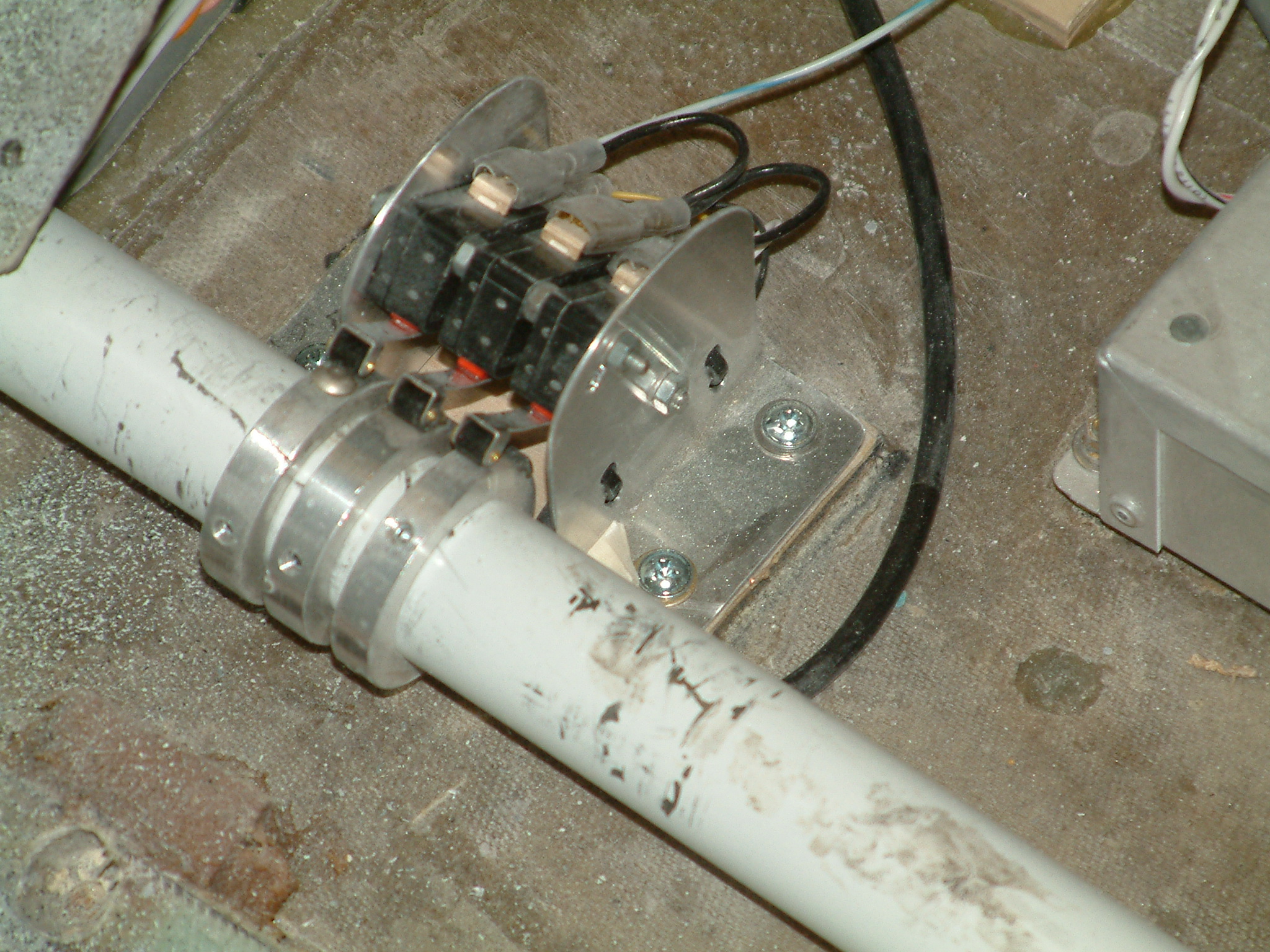

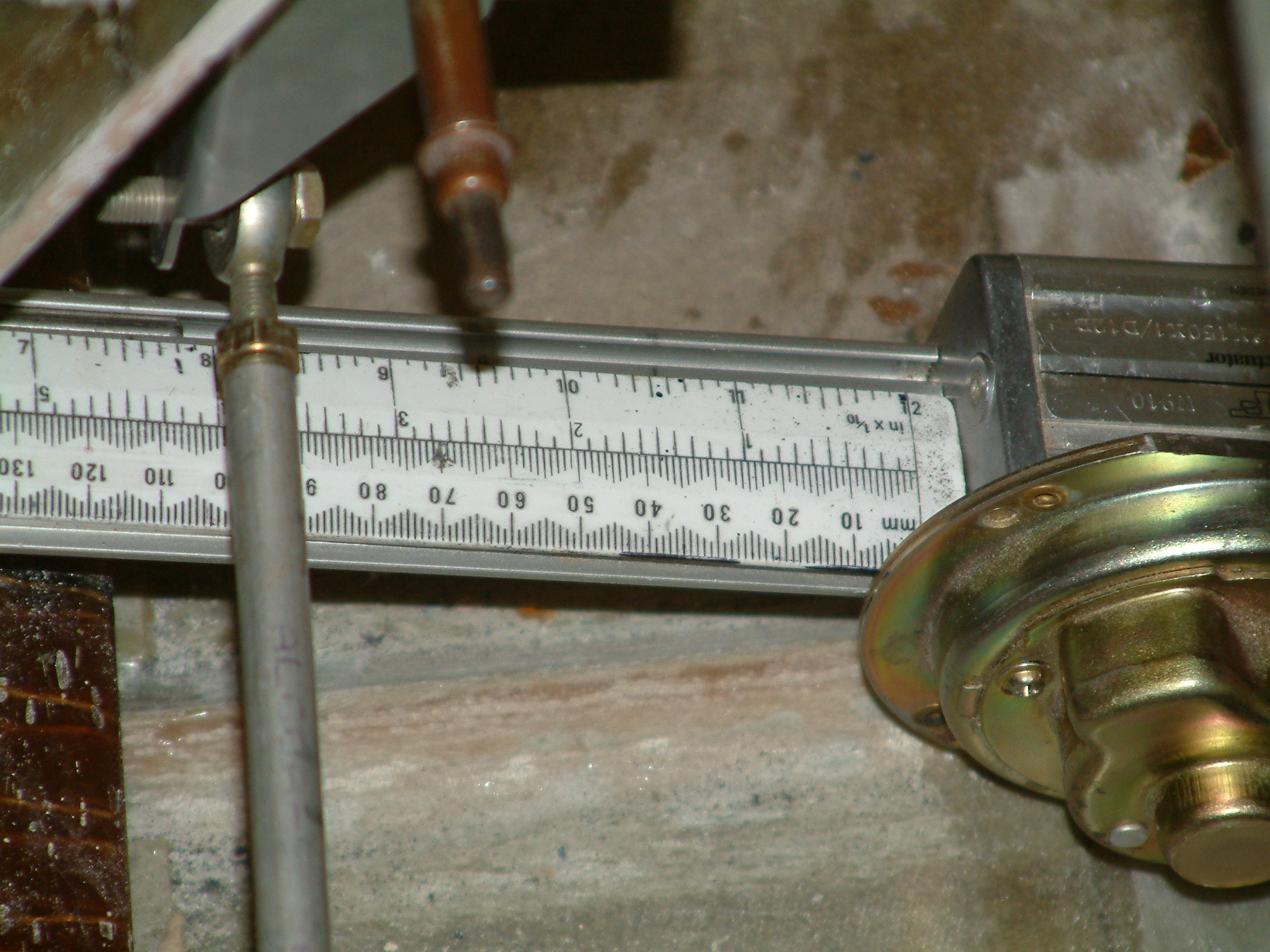

Alan - I have a Pulsar XP (similar cabin dimension specs to Rotax 582 powered Pulsar Series I). I found a way to very simply retrofit to electric flaps using Fergelli 2 In. linear actuator. The actuator mounts in control stick tunnel, no intermediate cables or pulleys and no need to tear up seat bottom during retrofit process. I can provide pictures and my telephone number for assistance.
Dave Weaver N912GR

David could you post the pictures to the group. I have an XP and would like to see how you setup the electric flaps.
If you have something you can email then send it to my email address of fgilmer(at)twlt.net
thanks Fred Gilmer

CYard52306(at)aol.com
PostPosted: Tue Sep 13, 2011 11:32 pm    Post subject: Electric flaps Reply with quote
In a message dated 13/09/2011 21:32:00 GMT Daylight Time, mortweaver(at)sbcglobal.net writes:
Dave
I am currently using a linear actuator but it is large heavy and cumbersome, do you have the model number and lb force rating, is the two inch stroke the best fit.I have enclosed a picture of miy fitting.
Regards Cy
