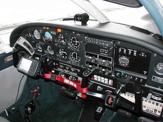

PostPosted: Wed Sep 14, 2011 6:22 pm    Post subject: Dash board edge trim Reply with quote
Aircraft Door Seals will custom make a glareshield to your template. I had one in my Cherokee and really liked it. It has a nice padded brow. I’m thinking about doing the same in my RV-10. I think it looks nicer that the cloth that Abby sells. But again, that’s my opinion.

 Filesize:  109.28 KB
 Viewed:  7751 Time(s)
