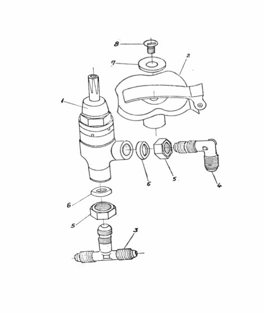

PostPosted: Tue Sep 06, 2011 12:04 pm    Post subject: Re: Low Emergency Air Pressure Reply with quote
I'm betting on the square o-ring in one of the red emergency valves in either the front or rear cockpit. I've had two leaks in 11 years - each time it was one of these o-rings. Item 6 on the attached diagram (the one on the bottom fitting).

PostPosted: Tue Sep 06, 2011 12:24 pm    Post subject: Low Emergency Air Pressure Reply with quote
Good point. There is a test that one can do to see if the problem is
one of the emergency air valves. Very easy to do.
- Observe and write down the pressure in both the emergency and main
systems.
- With the main air valve off, (assuming both emergency valves are
closed tightly), squeeze the brake handle until all air is depleted in
the system or until you no longer hear the "woosh" sound when you
release the brake handle.
- Now leave the pneumatic system alone overnight or for at least for a
few hours.
- When you come back to the airplane, squeeze the brake handle again and
if you hear the "woosh" sound again AND the emergency side of the
pressure instrument has leaked down, one of the two emergency air valves
is leaking.
Now it is just a matter of isolating which valve is leaking.
Dennis

Dennis / Bill,
Believe the protection valve Bill enquired about is the one located under the starboard side of the front cockpit seat (YAK-52).
Its vents the emergency air line (between the tap(s) and gear shuttle valves / uplocks) to atmosphere below 5 kgf/cm2 line pressure, to stop MINOR leaks from the taps or shuttle valve 'peas' interfering with normal gear operation.
For that very reason if you need to operate the emergency air system for real then open the tap quickly and fully to make sure the protection valve snaps shut (>5 kgf/cm2), otherwise you'll just waste the precious 3 litres reserve air ventilating the P1's derriere! Keeping in mind, having lowered the gear, you may well need what emergency air is left to also operate the brakes post landing.
Similarly the overnight air tap leak test suggested will probably be inconclusive for a YAK-52 because the air will most likely have been dumped externally by the protection valve as <5 kgf/cm2.
If the emergency air bottle has recently been disturbed for maintenance then I believe they can be troublesome to seat back on their seals ... which may be another aspect to consider in your leak down quest.
Good luck.
brgds, Rob R

PostPosted: Wed Sep 07, 2011 6:08 am    Post subject: Low Emergency Air Pressure Reply with quote
No, it does not. The YAK-50 has four check valves. Two for air input: One from the compressor, one from the external air. These come together at the pressure relief valve and prevent reverse flow.
Out of the pressure relief valve you go to a "T" connector which feeds an air strainer. The output of the air strainer, goes to another "T" connector where there are two more check valves. Top one goes to emergency air bottle, bottom one goes to main air bottle. Both go DIRECTLY to the bottles. The air shut off valve in the cockpit does not control air INPUT in any way to either bottle. It only controls air output.

PostPosted: Wed Sep 07, 2011 7:23 am    Post subject: Low Emergency Air Pressure Reply with quote
All excellent points Robb. Regarding the "fart" valve you mention and
refer to as the protection valve, if there is a leak from either one of
the emergency air valves and the protection valve bleeds the low
pressure off as you suggest, then one could use either a leak detector
or soapy water (or for that matter, stretch a balloon on the top of the
valve which would expand slowly) to determine if the leak is from one of
I can say this with carnal knowledge; the overnight test I previously
mentioned does work for a leaking main air valve.
Dennis
