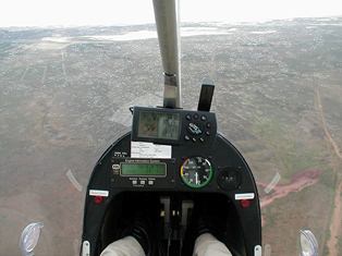

PostPosted: Mon Sep 12, 2011 12:03 pm    Post subject: rain tolerant prop Reply with quote
I have flown my FireStar II in the rain with an IVO prop with no damage.
[img]cid:tie_8CE3F9DD0A160B8_A6C_25416[/img]
 Filesize:  21.8 KB
 Viewed:  14670 Time(s)

PostPosted: Mon Sep 12, 2011 1:19 pm    Post subject: rain tolerant prop Reply with quote
Thanks for the additional suggestions.
Will,
What rpm is your prop turning and what is its diameter? The reason I ask is that my Jabiru was turning about 2900 rpm (direct drive) while trying to get home fast in the rain. This is about 150 rpm more than my normal cruise. Only the outermost 6-7 inches of the 64" prop showed any damage. At 2900 RPM and air speed of 90 mph. The tips were moving thru the air at about 640 mph and the inner most point of the damage it was about 520 mph. At speeds less than that, the TN prop leading edge seems fine.
In the future, when flying in the rain, I will consider slowing down to 65 mph and 2400 rpm which will mean the tip speed is about 520 mph.
Thom

Thom,
It is a 62" 3 blade IVO Prop and in the picture the EIS is showing 6330 RPMs
Will Uribe
FireStar II
El Paso, TX
But next month I will be working in Tonowanda, NY

Will,
Based on your numbers, assuming you have 2.58:1 gearbox and you are flying at 65 mph airspeed, then your prop tip speed is about 517 mph under those conditions. Based on your data and mine (admittedly small sample) about 520 mph or thereabouts seems to be the limit of at least composites before rain begins to cause damage.
Thom
