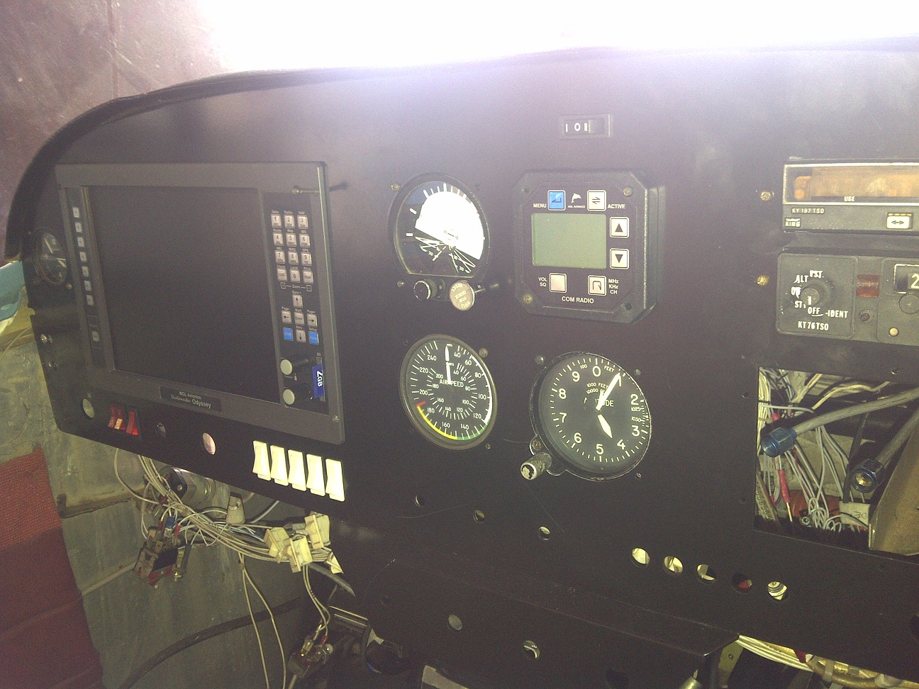

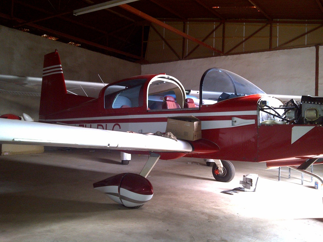

PostPosted: Sun Apr 15, 2012 7:51 am    Post subject: Re: AA5 - Winglets Reply with quote
Ned, I have only had the plane for a year now. I recently fitted an 0-360A1AD. Empty weight with the new engine is 1360, and I intend to bring it down a little more (prince prop and spline driven alternator are some of my ideas.) I am also busy with glass panel at the moment (pic attached) crossover exhaust and RV wheelpants. I am slowly fixing her up as she stood idle for 20+ years. I flew about 60 hours before the engine change.
 Filesize:  276.26 KB
 Viewed:  11057 Time(s)
 Filesize:  418.68 KB
