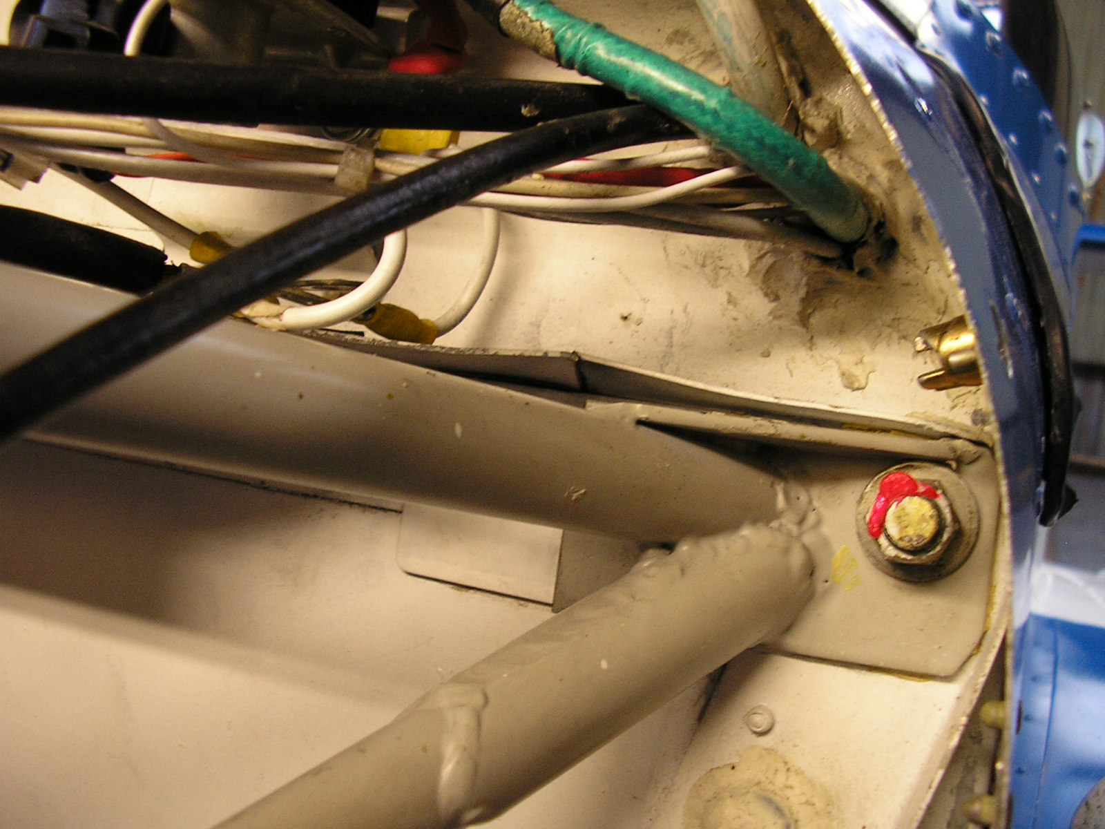

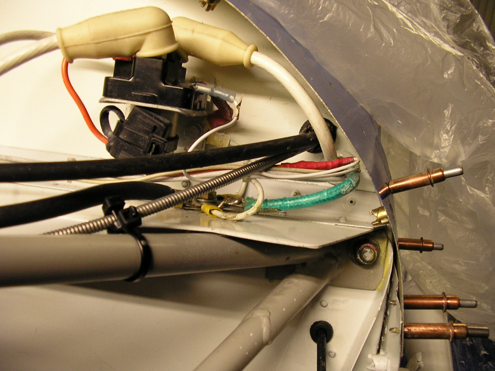

s.clive.richards(at)homec
PostPosted: Mon Aug 15, 2011 1:15 am    Post subject: 601 owners... something to watch for - engine mount fittings Reply with quote
Carlos
I donot have the drawing here to check number but pictures attached. before & after replacement .
Clive
 Filesize:  359.01 KB
 Viewed:  5334 Time(s)
 Filesize:  364.44 KB

<?xml:namespace prefix="v" /><?xml:namespace prefix="o" /><![endif]--> I guess I've seen one of the blessings of scratch building---I didn't feel comfortable with the mounts built as per plans; maybe a little chicken, but I built my upper mounts of 3/16th inch steel, with double facings, all welded together. Ugly? you bet. Heavy? Yup. Strong? Much more comfortable with that.
Paul R
foxatgibsons(at)gmail.com
PostPosted: Thu Aug 18, 2011 3:27 pm    Post subject: 601 owners... something to watch for - engine mount fittings Reply with quote
hello everyone i cant help but add a few comments  RE: cracked motor mounts
it  looks to me that there may be two issues that may be overlooked
a. there seems to be some irregular bead on the area where the tubes join/undercutting
b.  4130 tubing has a real issue with carbide formation at the HAZone .did the welder pre heat and
    did the welder nomalize  the cluster after the weld process
 knowing that a dh2c beaver motor mount  is made from .035 wall tube and it supports a much larger engine than a subaru
somehow i think the problem may not be just the thickness of the tube
cracks usually form at the end of a weld if the post heat is not applied properly
