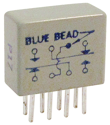

[img]cid:.0[/img]
This one clearly does not . . .
[img]cid:.1[/img]

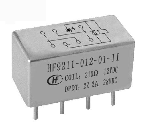

While the schematic on the enclosure for this one shows
a diode and clear (+) mark for the coil polarity.
If the relay you have in hand DOES include coil
suppression, then it will be clearly marked as such
in some manner on the outside. Otherwise, relay
coils are not polarity sensitive.
