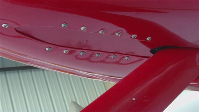

Tim,
I did this exact mod on mine. Mine was too close though so I opened up to
2.5 inches in front of the gear leg, otherwise when I land hard (ya right)
the front gear will flex far enough to hit it. Scott and I bounced the
plane from the prop and could easily hit the gear fairing before I opened
it. It makes lower cowl removal a breeze even by myself. I will take some
pics of it tomorrow and you can see if this is what you are talking about. I
have seven screws in mine. You can probably use less because that is how
many I used at first when it was a lot closer.

Sean,
Very interesting that you had to move it a whole 2.5"....I'm now
curious to see how that looks. It would seem to me that if
there were that much of a gap, it would still let in a lot of
air perhaps, at high angles of attack, but I can't visualize
it well enough. I'm going to have to draw it or do paper
cutouts and see. If you have photos, I'd love to see them.
Maybe it would be better if I attached a horizontal flat plate
to my leg fairing, just INSIDE the cowling...with some
appropriate bracing on top. That could then be allowed to
move fore and aft and as long as I built it with a tight gap to
the lower cowl, and maybe even put a weatherstrip around it,
it would stay sealed up, but from the inside. I would have
to draw it to maybe paint you a picture. It wouldn't
be as clean aerodynamically as a fairing, but it could serve
the goal of keeping air out of the slot, unless the pressure
would be so high that it would break the fiberglass "tongue"
that I'd have sticking off the gear leg.
opened up
to 2.5 inches in front of the gear leg, otherwise when I land
hard (ya
right) the front gear will flex far enough to hit it. Scott and I
bounced the plane from the prop and could easily hit the gear
fairing
before I opened it. It makes lower cowl removal a breeze even by
myself.
I will take some pics of it tomorrow and you can see if this is
what you
are talking about. I have seven screws in mine. You can probably use
less because that is how many I used at first when it was a lot
closer.

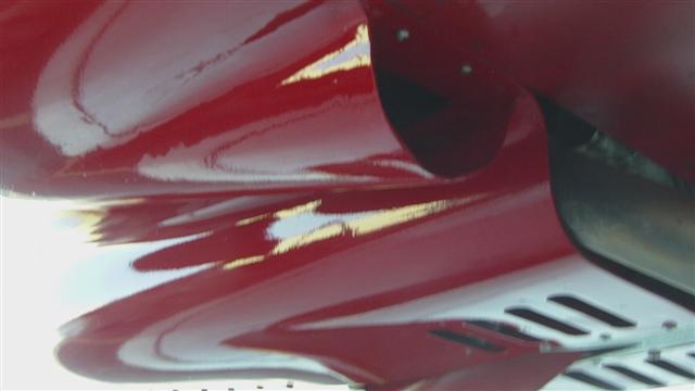

I have had to lengthen the slot on the lower cowl for the gear leg to allow
the lower cowl to be removed. I have an Aerocomposits 3 blade prop and the
lower cowl has to drop straight down in order to clear the spinner when
removing it. Even with the longer slot forward of the gear leg I still pull
down the tail to allow the front gear to drop down as far as possible.
Albert Gardner
N991RV
Yuma, AZ

PostPosted: Thu Jun 23, 2011 6:52 am    Post subject: Fairing Construction - How to? Reply with quote
I suffered from hi oil temps and adding a second oil cooler among other
things solved most of the problem, but the final solution was to add an
opening on each side under the oil coolers on the bottom cowl to allow more
exit air. Temp in Yuma yesterday was 113, temp in hell was 112, so yes, Yuma
is hotter than hell.
Albert Gardner

Tim Olson
Joined: 25 Jan 2007
Posts: 2882
PostPosted: Thu Jun 23, 2011 7:16 am    Post subject: Fairing Construction - How to? Reply with quote
That slot is pretty close to your gear leg.
Sean said he moved his 2.5" forward of the leg or
so, because the leg flexed forward under load,
and he wanted it to not hit that filler plate.
Do you find any evidence of hitting it?
If you don't, then that's exactly what I'm hoping
for....minimal gap between the leg and the cowl.
And, if you really wanted it tighter, with
a gap that tight, you could put a rubber
flap seal around it too if you wanted.
Just want to know if you've ever seen it hit.
