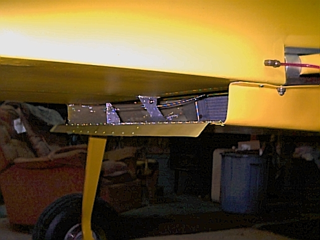

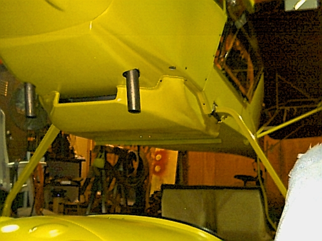

Agree with Lowell completely. Good advice. I used the same ratio for my scoop/fairing and it has worked fine for my purposes. Another thing, if I can add to Lowell's post, ensure that no air (zero) can escape around the radiator. What I mean is that if you enclose it (best, IMO), do not leave any gaps anywhere for air to bypass it, because that is exactly what the air will do. It is like water and will take the easiest path. It is extremely important to have high pressure at the inlet and low pressure at the outlet, otherwise the air will just bypass the whole thing and very little cooling will result. The best way to achieve this is a simple "lip" on the outlet side which will create a suction. This combined with the high pressure in front will drag lots of air through the rad. Better yet is to make that lip controllable.
I'm attaching some photos to illustrate what I'm talking about.
