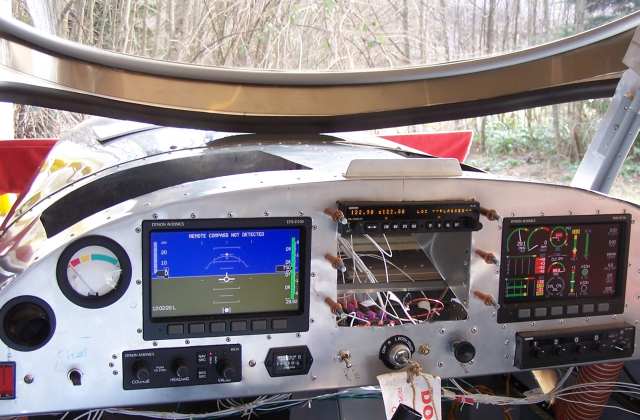

PostPosted: Tue May 31, 2011 9:17 am    Post subject: Instrument panel access Reply with quote
Here is a picture that gives you the general idea . . .
[img]cid:part1.09040407.04040600(at)att.net[/img]
Paul

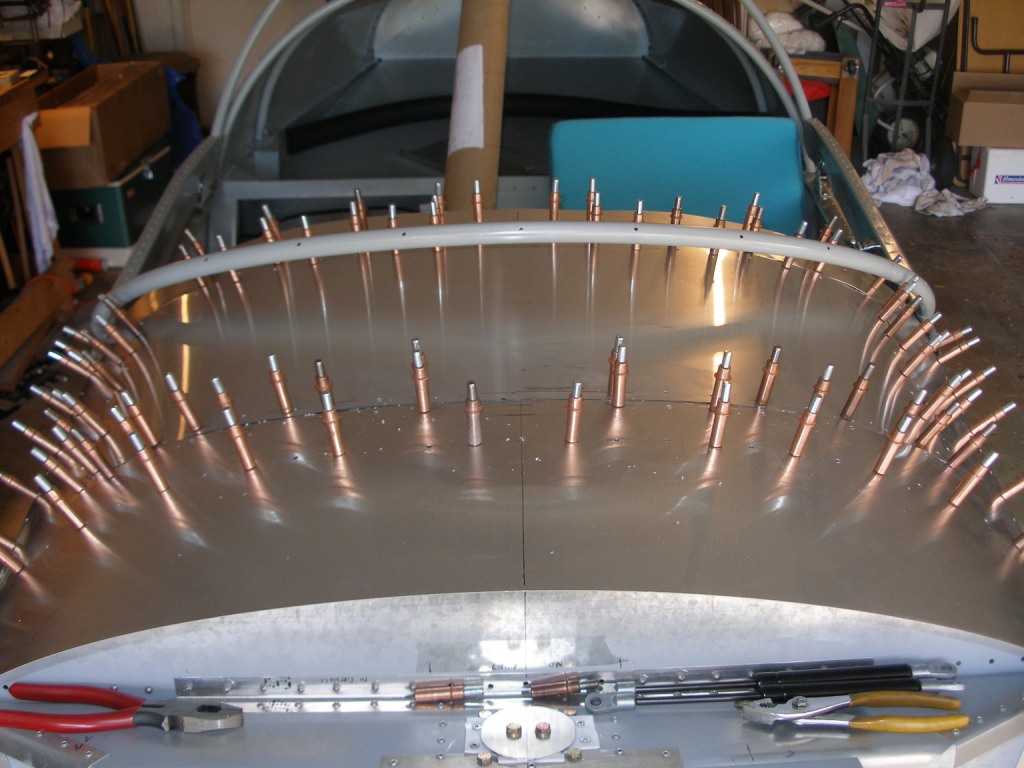

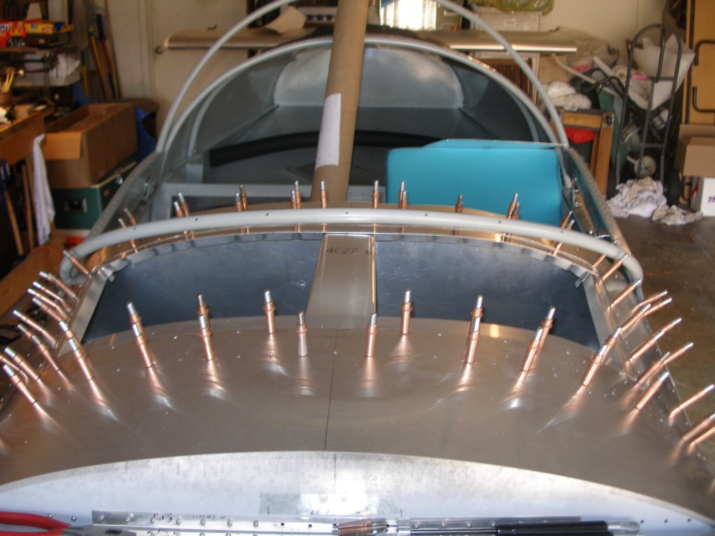

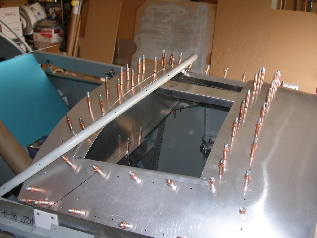

PostPosted: Tue May 31, 2011 9:57 am    Post subject: Instrument panel access Reply with quote
Larry,
Here is what I did. I used electrician's rubber tape instead of the silicone sealant for a gasket. I had that panel off many, many times working out bugs in the wiring.
Jay
