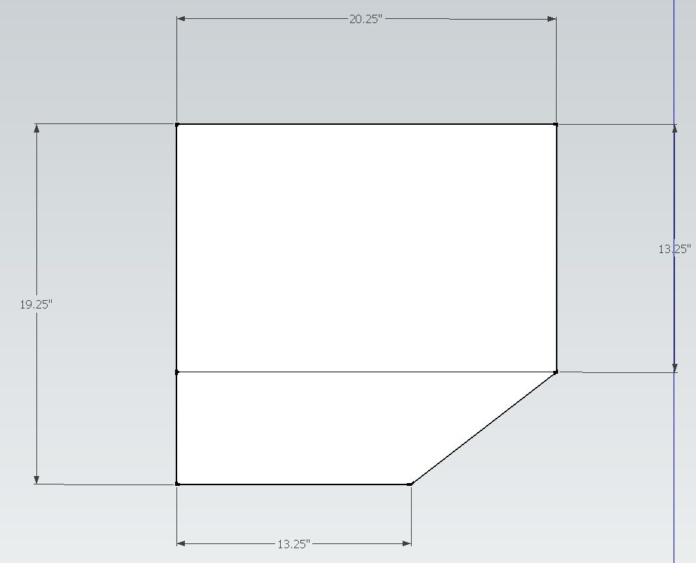

It's an odd shaped opening. Rounded down to the nearest 1/4":
-The vertical at the front is 19.25"
- The horizontal at top is 20.25
- A diagonal of 28" from lower LH corner to upper right
- But then you have to remove a triangle at the lower bottom rear corner
that is 7" horizontally and 6" vertically
The whole affair looks like (I hope):
Hope that helps.

I think I understand...  Does the attached drawing look about right?

That's it!
It's a very satisfying piece to assemble because it has a slight compound curve throughout it. Not sure how you would fabricate it without CAD and CNC... at least without n years of sheet metal experience... but it just clecos together and fits perfectly.

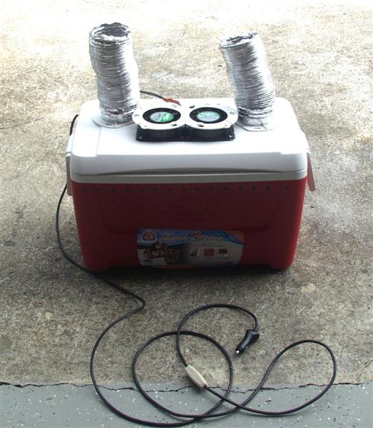

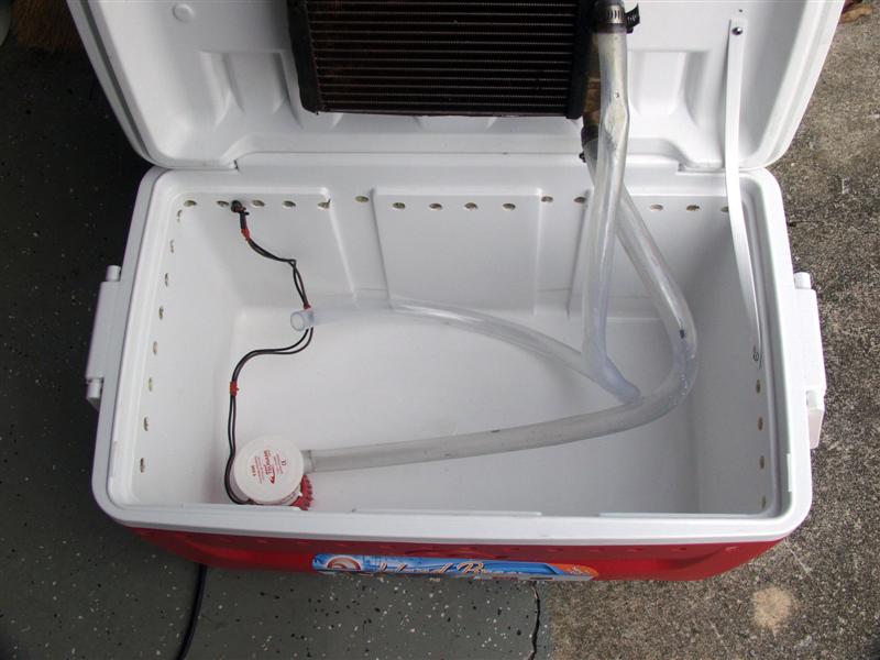

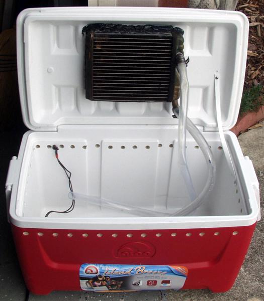

The dimensions of the cooler I use are 14X14X24, and it tapers slightly toward the bottom so that it slides in perfectly.
I'll attach the pictures I posted earlier. The cooler is at Walmart now for less than $20. It's the 48 qt. Island Breeze by Igloo.
I've modified the a/c cooler I made for Wes by wiring the fans in series instead of parallel. This cuts the amps down and still puts out a lot of cool air and doesn't use the ice up so fast. The 12v computer fans I use are actually for servers and put out more cfm than any others I've run across.
I think the advantage of this style that I've put together is that it uses the heater core (out of junkyard cars) as a heat exchanger that actually pulls moisture out of the cabin instead of just blowing air over ice.
I haven't gotten around to making the plenum yet that would sit on the console between the seats with directional air vents ... stay tuned!
