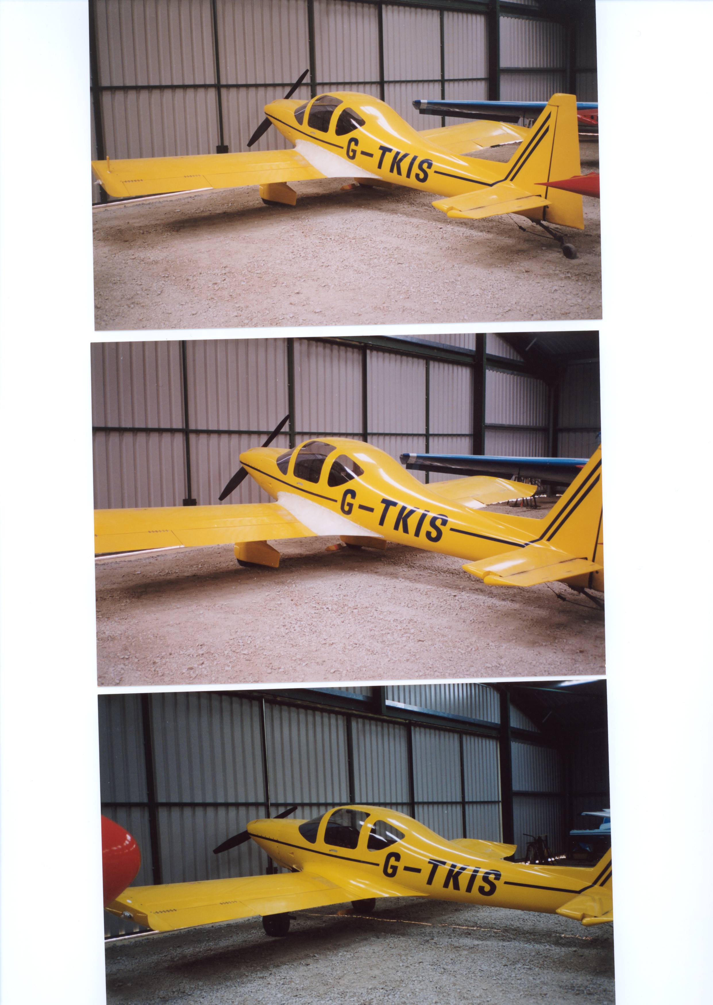

PS: Keep in mind that Julian Bond did extensive wing fairing mods to his KIS
TR-1. I have attached just one of the pictures that are available.

It seems to me it wouldn't fit well at the leading edge, but maybe your fairings are different than mine.
You can just make a layup on a flat table and make it work as long as you don't have to go around the leading edge very far, but I think with a little more effort you can make a part that matches the curve of the wing.
Scott

I think the best way to make the lower wing fairings is to get the airfoil coordinates off the web and cut two templates and make a sandwich with a block of low density foam and use a long sanding board to sand the foam to match the templates. I think you could make a nice mold in an hour or less and it would be the correct shape.
I made my lower fairings and my wingtips by laying up on the wing itself and I don't think using the top of the wing as a mold would produce a good quality part.
I would try to avoid dropping the wing unless you have to. There's a fair amount of risk of damaging things during the demate procedure and it might be a real challenge getting it all lined up again.  You can jack the wing up under the spar and remove one bolt at a time to inspect the bolts and bushings.
As for the engine... I assume you were running a wood prop? A lot of people I know would just check the runout on the crank and call it good after a low power prop strike with a wood prop.
Scott

Much obliged for the sage advice Rich.
Since the front part of the port upper fairing is also somewhat damaged that makes a lot of sense. Together with Tim's idea of using thin plate below the wing I think this repair issue is now resolved.
I'll get a professional to handle the wingtip, dent on topside of the wing and the tail fin.
The rest is easy enough if I can source a stock 3/16" windscreen from the guys in Los Alamitos who apparently have the mold.
  Alfred

PostPosted: Mon Mar 07, 2011 3:08 am    Post subject: PORT SIDE FAIRING Reply with quote
Alfred,
Hope i'm wrong .. but if have wing root fairing damage and
damaged Flap hinge ... it sounds like u could have damage at the rear spar
attach point ..... mine fractured there during a forced landing ..and my
wing didn't have any impact at all ..
Attached are the Pics of my damage ... i have a fix under way but other jobs
are taking priority at the moment ..
Graham

Hi Graham,
After working through the builder's manual over the weekend I arrived at the same conclusion.
Rich did of course spot that in the first instance and said that repairing the rear spar bushing would not be difficult. So I'm not too worried as we also did not notice anything amiss there during the first inspection. I shall surely take a closer look at that particular area tomorrow.
Perhaps I'll even drop the wing tomorrow ... Scott's advice to avoid dropping the wing is sound, but I need to be sure about the spar after the unusual loading from the top it got from the Cessna's tail section. By doing it myself I'll learn quite a bit about the plane. Besides, it will save me a bit on the repair and the repaint of the wing (and perhaps even reduce hangar fees if I reduce the area occupied for the time being Surprised).
Will take some pictures tomorrow.
Alfred
