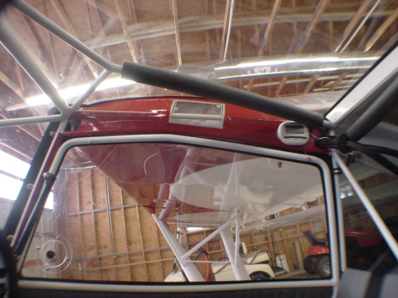

PostPosted: Mon Mar 07, 2011 4:45 am    Post subject: Re: Head protection Reply with quote
This has been a concern of mine too. I went down to my local Home Depot and purchased pipe insulation for tube padding. Works just fine.

Oh yes. I covered the tubes to the side and rear with foam tube
insulation. I've used them many a time, as I fly in any turbulence. The
hard one to protect is the perfectly vertical -1 g bump that raps your
headset band smartly into the skylight. I once saw a Kitfox skylight hit
so hard this way it popped the fasteners along one side and back edge.
I'm getting shorter with age though so maybe this won't be a problem in
the future. Wink
