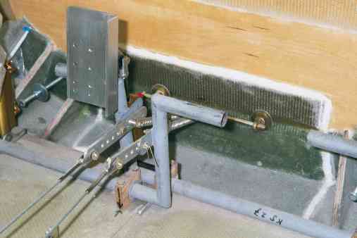

This is a very crucial issue. There are four things wrong with the orginal
KIS TR-1 rudder pedal - brake arrangement.
A) The rudder pedals are too small. This means that one can not get
sufficient leverage when pressing on the top of the pedals to apply the
brakes -- particularly with the early on crappy Matco braking system.
B) There is no means of telling precisely where your foot is located on the
pedal and the foot can slide off the side of the pedal very easily.
Both of these problems can be solved with aluminum angle extensions riveted
onto the original pedals. See the attached picture.
C) The rudder cross bars are too short. This means that in order to place
one's feet properly upon the rudder pedals one must angle one's legs
slightly towards the center line of the airplane -- off a bit to the right
for the pilot.
D) The mechanism for mounting the pedals to the floor board is too weak and
flexible. Considerable beefing up in this area is needed while constructing
the floor boards and any bolt pivot supports should be supported on both
ends, not just cantilevered.
2) "The release mechanism on a vernier throttle......."
I do not recommend vernier controls on a throttle -- just push / pull with a
friction adjustment.

For my KIS , I did not like the offset pedals from the first moment I
mounted them and sat in the plane, it clearly felt wrong so they were
modified quite easily by cutting and welding the pilots left Pedal and
Co-pilots right pedal exactly in the opposite direction , this eliminates
the off set feeling completely Plus as OC mentions adding aluminium
plates to the pedals to make them easier to find and operate

Please add me to the camp that thinks a vernier on the throttle is a bad idea. Reducing throttle should not require 2 actions.
Some builders have cut off the inward turned outboard rudder pedal tube and rewelded it so that it is outboard pointing. This allows the outboard rudder pedal to farther outboard so that they can be centered. This will increase stress on the part so really this whole tube assembly should be rebuilt or at least reinforced.
Mark
