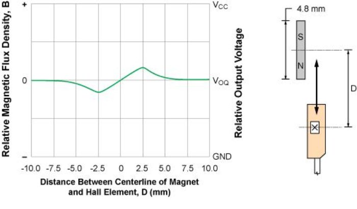

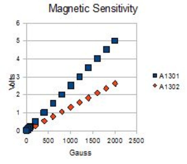

Sounds like an interesting project, Mike
I had not seen a magnet mounted in that orientation to a Hall effect sensor previously (but, then my experience with their use is quite limited), however, it became clear (based on the graph below) that that specific orientation provides a way to determine which side of the pitot center line (air flow vector) the van is pointing based on voltage magnitude.
If VCC is 5 volts, then it looks like 2.5 volts would be VOQ - in which case, a voltage above 2.5 volts would indicate the vane was pointing in one direction (say Up relative to orientation of pitot tube)) and if voltage is below 2.5 volts the vane would be pointing to the opposite direction (say Down relative to the pitot tube). The magnitude of the voltage would then indicate the degree of variation from the reference point.
The sensitivity of both of the subtitute sensor you mentioned are in millivolt/gauss mv/g. The old sensor apparently was around 1.3 mv/g with the A1301 being more sensitive at 2.5 mv/g than the A1302 at 1.3 mv/g
The effect of substituting the more sensitive A1301 would in effect increase the voltage swing by 2.5 / 1.3 = 1.92 or almost twice the voltage swing for the same gauss strength over the less sensitive Hall sensor. This would undoubtedly call for a different calibration point in the processing circuit - but should reduce the effects of electrical noise with a higher voltage input. (See Spreadsheet graph of this effect below)
If you did not change the circuit calibration then I suspect the what you would get (without having analyzed the circuit) is that your LEDs would in effect indicate approx 1/2 the degree variation of the less sensitive sensor. In other words, you would hit the voltage limit excursion of your LED (due to the 2 times higher voltage per gauss) in about 1/2 of the angular variation of the less sensitive sensor.
[img]cid:3A5913E9902A4428A8177526CFE55E75(at)EdPC[/img]
[img]cid:963D45B0691544578B9A1BE836D56304(at)EdPC[/img]
In plotting their comparative sensitivities to magnetic field strength change I derived the above chart - so as you can see for the same magnetic field strength the A1301 gives you approx twice the voltage swing of the less sensitive 1302 sensor
So for example, at approx 2000 on the gauss scale that would give you around 2.5 volts vs almost 5 volts for the 1301. So your LED (at 5 volts output) would be maxed out at 1/2 the gauss (degree divergence?) strength of the less sensitive sensor - but, I would assume you could compensate for that in the calibration or an resistor of twice the called for value someplace in the circuit - otherwise, just go with the drop in replacement the 1302.
voltage magnitude.
