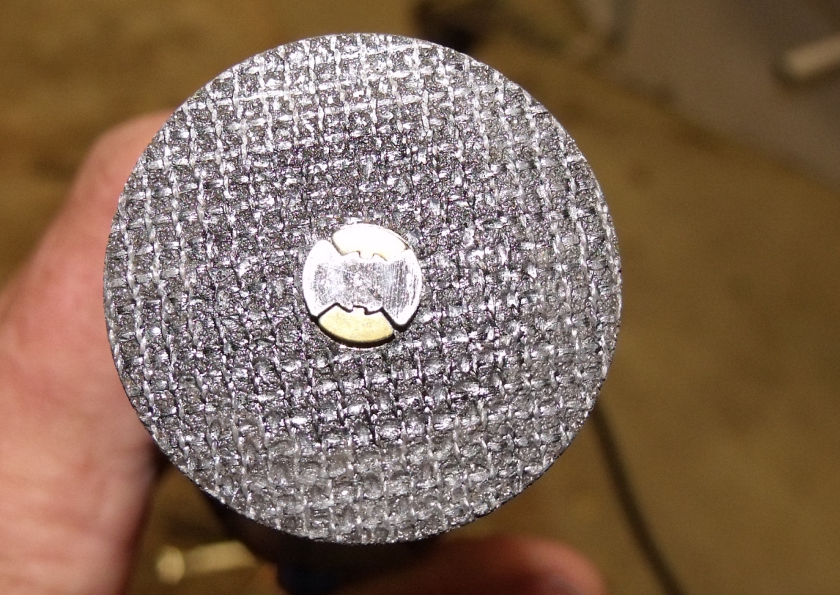

A couple of months ago I was in Lowe's when I remembered I needed a package of cut off wheels for my Dremel. At the display I found they have a new cut off wheel and drive mandrel out. The old ones were fragile and used a single screw to attach the wheel to the mandrel. The new one uses a spring loaded collar on the mandrel with a positive drive key to engage the wheel. The whole thing is just plain slick. The new cut off wheels last 3 to 4 times as long as the old ones even going through alloy steel. I cut the heads off two AN 5 bolts and the wheel only lost an 1/8" off its diameter. If you go to Lowe's look carefully I found the mandrel and five wheels as a special for $15. Separately they're about $18. Just to keep this specifically Kolb related, I was removing the elevator hinge from the horizontal stabilizer of a Mk IIIX yesterday. The original builder did a poor job of drilling the holes and every one of the stainless steel pop rivets spun before the drill separated the head from the body. I used the edge of the new Dremel cut off wheel to shave the head head of the rivet until I could just see the line concentric to the center hole. A light tap with a punch and the rivet was removed with no more damage to the hole. I did all 48 rivets in about a half hour and moved on. The cutoff wheel barely showed any wear.

Mike, The old cut off wheels I was referring to are the fiber reinforced ones with a 1/16" center hole for mounting. They were just too fragile for most anything and if you pushed them too hard the center cracked out and you were done. As you can see the new ones are much more robust.

  The disks that I was referring to were fragile, unreinforced kind.
If you breathed on them hard, they broke!!  Pretty near useless, IMO,
unless you were cutting balsa wood....slowly!!
  The 'much better' ones I was referring to are the fiber reinforced ones.
I generally got lots of mileage out of these....that is, unless I bumped
them sideways, or layed the tool down too hard.  I have bent in half
dozens of these.  Yes, they do have the rediculously little 1/16" hole!!
  I haven't seen the new cut-off discs you're referring to.  I'll make it a
point to check them out.
