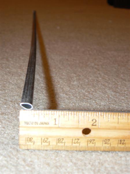

This is overexposed, but you get the idea: OD 5/16" X 5/32" X 35", ID 1/8" X 1/4". Got it at the local RC hobby shop, thinwall aluminum, weight 1/2 oz. Ought to be able to slip a tail brace wire through it during cable assembly, Goop it to an end fitting to keep it from pivoting. Use 2 pieces, each one attached at an end fitting, leave the middle of the wire uncovered so you could still fold the tail? Maybe squeeze it thinner so that it has less cross section?
Food for thought...
