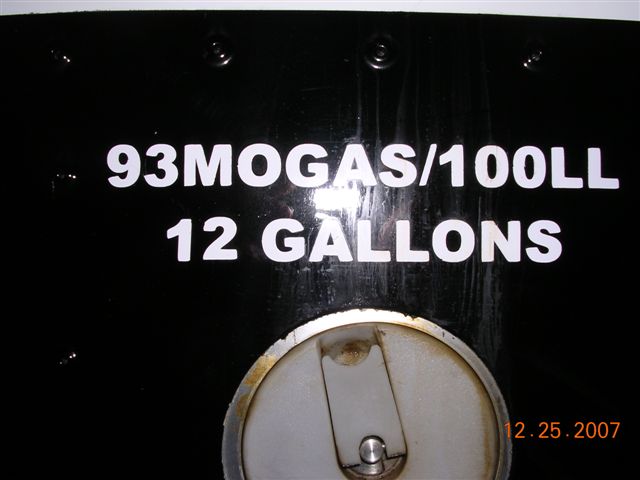

PostPosted: Fri Dec 31, 2010 2:35 pm    Post subject: Fuel Decals Reply with quote
Here's how I labeled mine.

PostPosted: Fri Dec 31, 2010 7:26 pm    Post subject: Fuel Decals Reply with quote
I use 1100LL only so I labeled it that way. For that I simply used a sticker from ACS. Frankly, you can add the 95 Octane label with a "permanent marker" until you get the plane painted. Don't forget to label the capacity of the fuel tank too.
