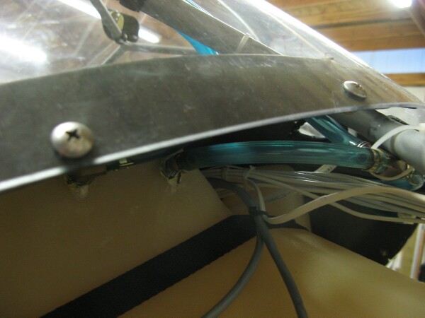

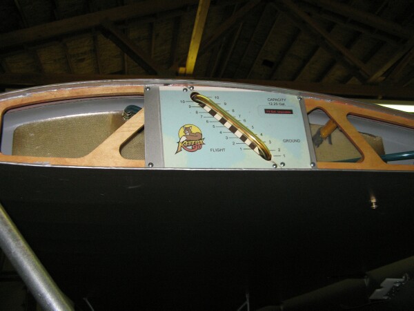

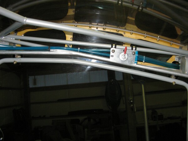

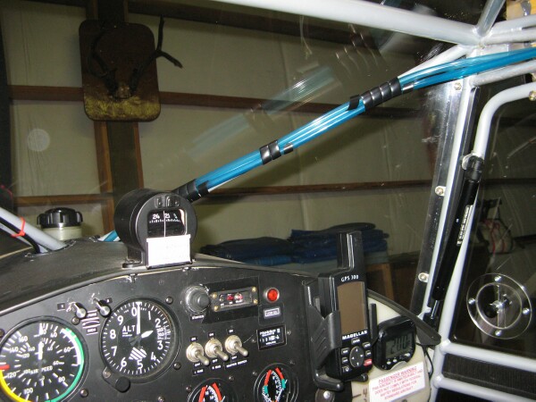

James, I had mine plumbed like yours are but also did not like the low spot in the line under the door. I changed it to how the service Bulletin recommends with the panel tank. In the last picture the line under the windshield screw on the left is the main line from the wing tank. The other line is the vent. The vent line is connected to each side of the two high spots of the panel tank and a T in this line runs to the top of the wing tank. You can see the vent line and fitting in the top of the wing tank in the site gauge picture.
One advantage of a rear header tank is it makes for a good down hill slope all the way from the wing tank. In the pictures you can see the slope in the lines above the door is just about level with the panel tank routing. To get all the fuel in the wing tank to drain I must fly with that wing high for a little while.
Service Bulletin #29 http://www.kitfoxaircraft.com/support/service_bulletins/sb29.htm
