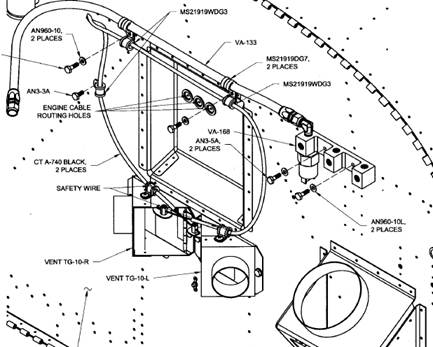

As many have mentioned, I purchased these parts that are indicated on FF1-3 that would be easier to install before the engine mount.
I wanted to get the engine mounted so that I could start working on the cowl. Since I'm on the incur no debt plan, I didn't have the cash for the FWF kit. So to more effectively manage my budget, I just ordered these parts in advance. I'll order the rest of the FWF kit a few months down the road.
Bob

PostPosted: Fri Dec 03, 2010 5:38 am    Post subject: fwf/engine hanging procedures Reply with quote
With that stuff mounted you should be fine with a final mount of the engine. Do you have the control cables? Make sure you have the holes enlarged and then you should be good to route them with the engine on. All of those parts listed are the parts that can be installed after the engine is on, but are much easier installed before the engine.

I've been going over the fwf list that Bob L. had in the archives, it showed 3 black cables, 2 for heat, what is the other one for?
3.00 CT A-740 BLACK PUSH PULL CABLE BLACK

PostPosted: Sat Dec 04, 2010 8:55 am    Post subject: fwf/engine hanging procedures Reply with quote
alt air door for air box
dlm46007(at)cox.net
If you are installing a parking brake you will need to buy an extra.

PostPosted: Sat Dec 04, 2010 8:56 am    Post subject: fwf/engine hanging procedures Reply with quote
Hey Dave,
We used that one for the bypass door on the air filter.
Later, - Lew

PostPosted: Sat Dec 04, 2010 9:05 am    Post subject: fwf/engine hanging procedures Reply with quote
Alternate air flap for air intake assembly?
Bill

PostPosted: Sat Dec 04, 2010 9:16 am    Post subject: fwf/engine hanging procedures Reply with quote
alternate air

PostPosted: Sat Dec 04, 2010 9:36 am    Post subject: fwf/engine hanging procedures Reply with quote
If you have an Airflow Performance Throttle body (FM200 / FM300) you will also need one for the Purge valve.
I chose Red for the heat and black for the Purge & Parking Brake.

ok thanks, I assume FAB kit comes with alternate air hardware?

FWIW, my FAB kit came with a black cable, too, so I ended up with an extra.

You have two cable for cabin heat.
One cable for the emergency FAB bypass door on the bottom of the airfilter box.
One cable for the Carberator heat which cuts off the air from the cowl scoop intake and allows hot air into the filter box via the cowl air inside the engine compartment.
I needed to purchase one more cable for the oil cooler butterfly valve.
The subpanel looks pretty goofy with five black handles sticking out of it along with the Mixture, prop and throttle.
Maybe someone will put the control for these on their control stick switches(just kidding!)
