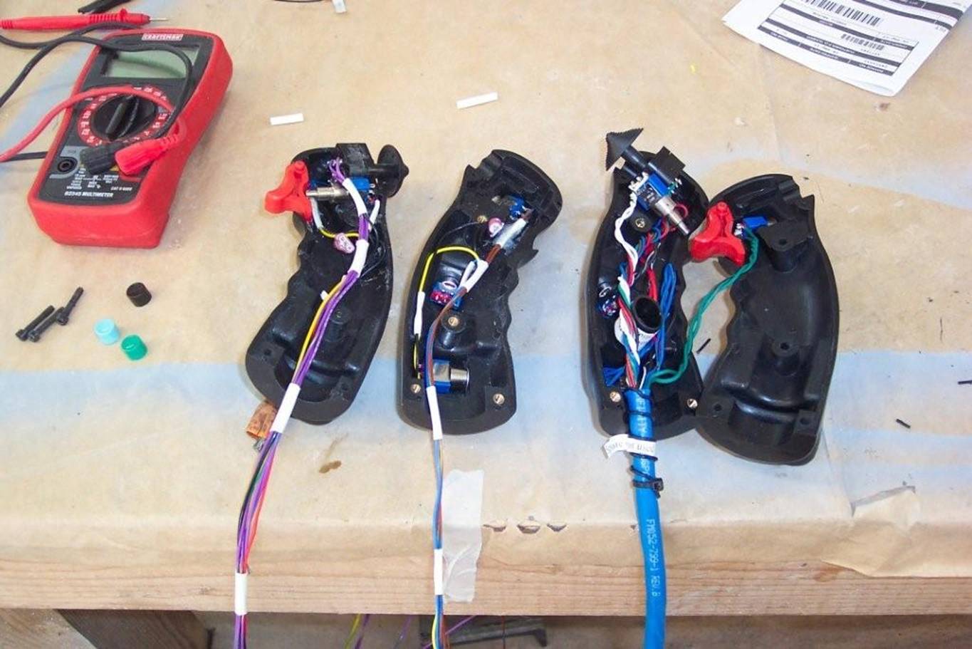

lessdragprod(at)aol.com
PostPosted: Thu Dec 02, 2010 8:25 am    Post subject: infinity grips Reply with quote
Hi All,
It looks like there is a combination of similarities and differences in switch functions.
My list is:
Trigger - PTT
Hat - aileron/elevator trim
Thumb (right of hat) - Starter (with panel switch in series)
Thumb (left of hat) - Flap (toggle switch on/off/momentary on)
Thumb (halfway down the stick) - #1 radio flip/flop
Pinky - Autopilot engage/disengage
The front stick on my Less Drag Special (modified HR2) is hard wired with the 17(?) wires.
The rear stick only has the 4 wires required for the Cann Aerospace Buss card. The rear stick will not be wired into the system until I install the Cann Buss modules. The rear stick will have a enable/disable switch on the instrument panel. (future development)

PostPosted: Sat Dec 18, 2010 8:29 am    Post subject: infinity grips Reply with quote
The infinity Grip site is a confusing mess. Calling Infinity when I ordered my grips for the RV-4, RV-6A RV-10 and most recently my 8A was the exact same song & grumbling dance. "Did you see the order form on the website" "Yes but it was confusing and I didn’t want to make a mistake in ordering." That is how everyone of my conversations went with JD but in each case we went through the choices & options and the ordering took about 20 minutes to get exactly what I needed. Just understand what switch, button, toggle you want including type of switch (momentary, push on/off) and of course what hand orientation your grips should be. Don’t forget the button switches are available in different colors so decide ahead of time your AP disconnect color vs. your Flip/Flop button color. Know ahead of time the amount of wiring length you want because he sells the bundled wire by the foot. Once you have completed the grip transaction be ready for the hard sell on his engine pre-oiler and a few other items. I thanked him for the suggestions but passed on those items. I think this the best & most accurate way to order these grips. In the end I get what I need and have discussed the choices with the most knowledgeable if occasionally a touch gruff developer of the product.
"Best time to call is after 1400 CA California time, and evenings, at (619) 448-5103 ."
A note on the wiring. His bundle of wiring in the blue sleeve has a LOT of wires in it. I think each wire has an associated ground wire. This bundle is difficult to fish through the control stick. Don’t flake out and run the wires external to the stick. I suggest you eliminate most of the ground wires that you don't need and fish the balance of the wires through the stick. I call my set up "hillbilly wiring" but it works well and is much cleaner than an external wiring job. BTW I am not saying it is impossible to run the entire bundle through the stick, just very difficult. We finally learned on the 8A the best technique.

On Dec 18, 2010, at 9:25, Robin Marks <Robin(at)PaintTheWeb.com (Robin(at)PaintTheWeb.com)> wrote:
<image002.jpg>

I left all wires as-in, in the blue sheath, and was able to run
the blue sheath through the stick so that it exits the stick
under the seats. I think it's nice having that thick chafe
protection on the wires.
