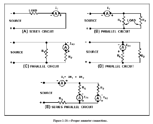

Some people explain "parallel and series" circuits differently than you . . .
May I suggest that differences in explanation have
more to do with illuminating the speaker's understanding
than it does with debating the value of various
'interpretations'?
I'll refer the debaters to the Z-figures were there
are numerous examples of how the subject capacitor
is wired. I'll also cite every text I've ever
picked up wherein Ohms law, reactance, and measurement
of currents and voltages are explained in uniform and
explicit illustrations for series and parallel connections.
An exemplar figure from the texts I used at Great Lakes
Naval Training Schools:
[img]cid:.0[/img]
This goes to the value of common understanding
of the words used in language. Without common understanding
the useful exchange of
ideas and knowledge cannot take
place.
the useful exchange ofideas and knowledge cannot take   place.
