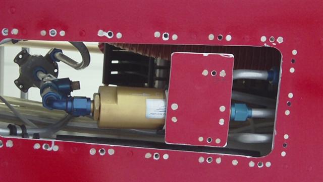

PostPosted: Wed Nov 17, 2010 10:02 am    Post subject: Fuel Filter Reply with quote
I made this cutout under the fuse to allow access to my filter from underneath. Works good.

"When I was building, I was concerned about having only one filter - if it
gets blocked you're coming down"
I am not sure this is true for the stock build. I would have to go back and
look, but there is a bypass line and check valve built in. I am not 100
percent sure, but maybe 90 percent.
Anybody else know for sure.
