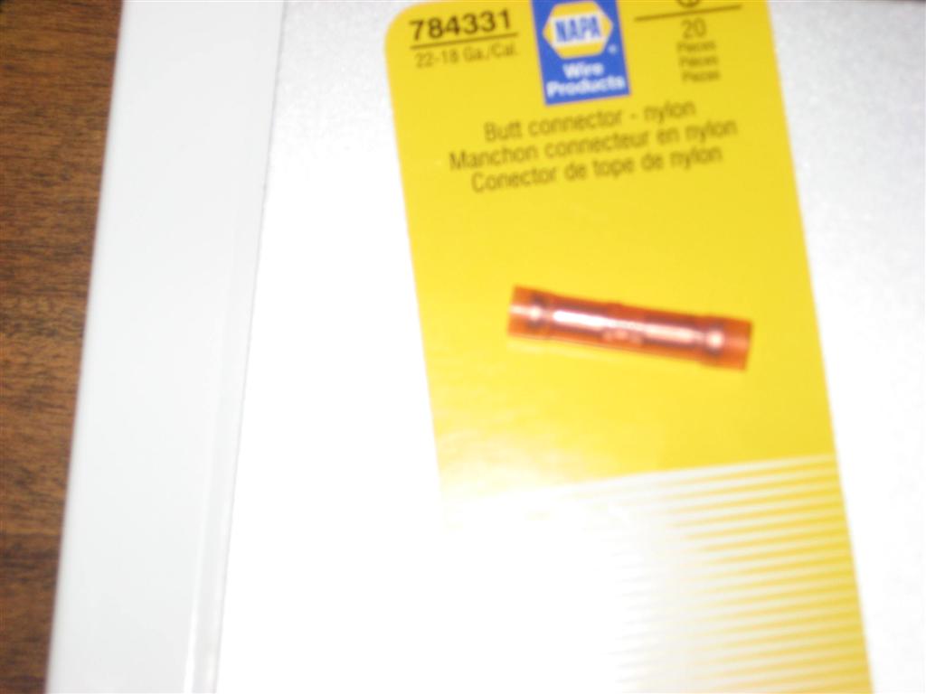

PostPosted: Fri Nov 05, 2010 3:39 pm    Post subject: Fuselink Link 14/10 AWG connection Reply with quote
I am 1000 miles away from my shop, but I have a package of the new
style butt connectors in my truck. NAPA P/N 784331. They are reds
tranlucent plastic and have the extra metal extension. I use several
rachet crimpers and they all give a good result with these things.
Takes 2 crimps with my crimpers to grab theinsulation.
Branded by Balkamp (a NAPA house brand). Made In Taiwan
The other stuff in my truck are the cheepe 3M automotive stuff you
are fanmiliar with and they will not grab the insulation. However
they do give the soild crimp like your AMP tests.
Mabe the attached pic will reveal something?

PostPosted: Sat Nov 06, 2010 5:38 am    Post subject: Fuselink Link 14/10 AWG connection Reply with quote
Hmmm . . . are these normally stocked in the stores
or do they have to order them in? Are they available
in less than full box lots?
pwmac(at)sisna.com

PostPosted: Sat Nov 06, 2010 8:45 am    Post subject: Fuselink Link 14/10 AWG connection Reply with quote
At 09:12 AM 11/6/2010, you wrote:
Stock item in Durango CO store. Stock from the Albuerque warehouse.
Find then on the shelf. no need to ask at the desk.
Paul
I'll see if I can pick some up. I'm going to Wichita
tonight.
