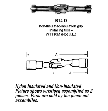

We've always had an interest in fabricating one-wire,
'serviceable' splices in certain wires. If one wanted
to avoid installing a one-pin connector, then some form
of breakable splice was called for. For the three weeks
I spent on the Cessna 310/320 assembly line, I installed
a bucket-full of "wrist-locks" . . .
[img]cid:.0[/img]

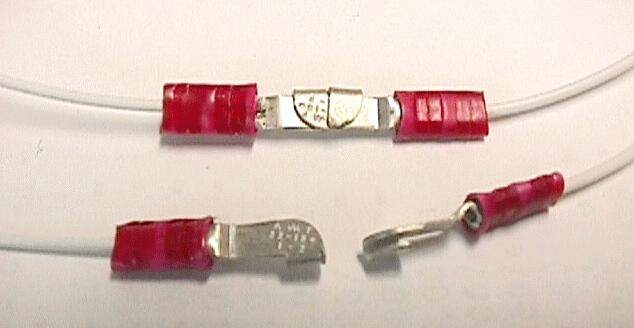

In other venues, the knife-splice was favored . . .
[img]cid:.1[/img]
Both technologies were covered with an insulating sleeve
secured in the center with a tie of string. Today, one might
use heat-shrink. Both technologies offer a tug-resistant
splice with good integrity.

In the mean time, there's nothing 'wrong' with knife-
spices or wrist-locks if they meet your design goals.
