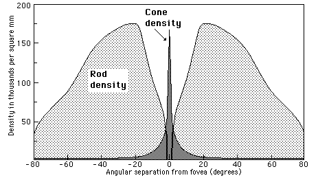

Rods surround the periphery of the eye and are used for peripheral vision, and night vision. They do not see color, and do not detect motion. Rods only provide non-color vision at an acuity of 20/200. Rods are most susceptible to blue light. You never read, or scan your instruments with your Rods - or your peripheral vision - think about it. You are reading this article with your central vision - your cones.
Cones are used for color, central vision, with visual acuity of 20/20. The cones have a focal width of approximately 20 to 30 degrees. Cones are most susceptible to red light.
Cones are used when you read, day or night. During the day we read with our cones - during the night we need a light to read - obvious, but it shatters the red light myth in the aviation cockpit.

  • That nothing can be seen directly in front of the eyes (no rods in the center of the retina), you must learn to look about 15-20° off center.
  • Only motion can be detected well, therefore you may have to learn to move your eyes to detect something that doesn't move.
  • Objects that aren't moving appear to move (autokinesis). This has probably led to a number of plane crashes.
If you need to see directly in front of you or see detail you need red. Like many myths the red light myth has some basis in fact. The red truth?
Why red? The center 1.5% of your retina (the fovea) which provides you with most detailed vision is packed almost exclusively with red sensitive cones.
This is the same area that has no rods and is responsible for the night blind spot. There are fewer total green sensitive cones than red. The number of blue sensitive cones is very small compared to green and red.

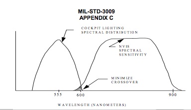

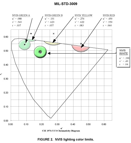

LITELite NVIS Compatibility
MIL-STD-3009 was developed by the Department of Defense in February 2001 and superceded MIL-L-85762A. It specifies that NVIS White for crew cockpit and utility lighting. NVIS Green A is grand fathered into the cockpit for certain applications, but not for new applications.
The chromacity of NVIS White makes it a full spectrum light even though is appears to have a green tint. Visible light can be split into the three primary colors, red, green and blue. The eye needs two primary colors to see 'white'. NVIS White, in simple terms is blue range through the green range. NVIS goggles filters allow a thin band of green light though the lens - so that users can see heads up displays and other required applications through the goggles.
The level of light with respect to the chromacity is important due to this leak (filter) in the goggles. Other manufacturers claim to be the 'only authorized' lights produced since they meet a request for proposal standard. These claims are false - they have never tested FLITELite products how could they know? FLITELite meets and exceeds non-binding RFP standards, AND meets the modern, more stringent MIL-STD-3009, which is a binding requirement specified by the military.
General Aviation pilots can benefit from this technology. This light spectrum and intensity is perfect for general night vision use as well.
Read MIL-STD-3009 here.
FLITELite minimizes the crossover zone by using a special combination of LED's and Filter material. The filter material ensures that the light greater than 600 nm is not transmitted.

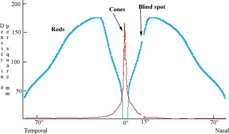

[img]image002.gif[/img]Chart showing the distribution of rods vs cones. Note the absence of rods in the center and the absence of both about 15° away from the the center toward the nose where the optic nerve passes.
[img]image003.jpg[/img]
[img]image004.jpg[/img]

The eyes are comprised of Rods and Cones. We hear people talk about Rods being for night vision, and Cones for day vision, and while they both have their special attributes, it would be better to classify them in the aviation environment at Peripheral (Rods) and Central (Cones) vision. Both rods and cones have a day and night mode, and they both react to light at different rates, and to have sensitivity to different light frequencies.
Which is just as well since the lens in the human eye cannot focus red and blue at the same time. And using green really only changes perceived brightness because of the way the signals are processed in our neural pathways. Unlike a digital camera, more pixels, in this case, doesn't give us more detail.

rod density vs. conesChart showing the distribution of rods vs cones.

[Update 14 Dec 2003] A very important point barely mentioned in the
original is that human peripheral vision is almost completely rod based!
The implication then is that we cannot see color at the edges of our
vision. If you think we can, try this simple experiment. You will need a
small assortment of color cards (try sheets of construction paper) and
someone to assist you. Sit looking straight ahead while you’re
assistant, about 6 to 10 feet away, slowly moves a random color card
into the margin of your vision. Now, while still looking straight ahead,
what color is the card?
This is the second most important factor that has been ignored in the
design of outdoor lighting, the first being glare! However this study
<http://stlplaces.com/cgi/redirect.cgi?http://dmses.dot.gov/docimages/pdf66/133155_web.pdf>
(in pdf), at the U. S. Dept. of Transportation, is a subjective study of
blue tinted headlamps.
Read MIL-STD-3009
<http://www.flitelite.com/isite/support/MIL_STD_3009.pdf> here.
http://www.flitelite.com/isite/images/nvischart.jpg
http://www.flitelite.com/isite/images/range.jpg
http://www.flitelite.com/isite/images/nvissys.jpg
