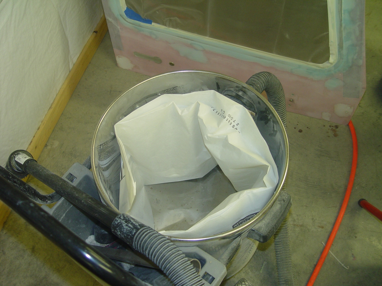

The secret weapon for my Shop Vac is to use the optional filter bag. I have a "shop-vac" from Lowes or HomeDepot. It comes with a foam filter covering the fan input but disposable filter bags are sold as an option. The bag captures virtually all dust keeping not only the exhaust dust free, but also the inside of the vacuum. It has a lot of surface area so it doesn't immediately clog. Very effective. I figured this one out when doing some concrete grinding in the house.... there are things worse than fiberglass.
If you are using a standard wet/dry shop vac - get and use a filter bag for better results. Change it with reasonable frequency.
Fiberglass, sandpaper, and a bagged shop vac - we're attached at the hip. Now if I just had a remote control for the thing.
Will try to attach pic...
Bill "taking a last pass on the doors" Watson
