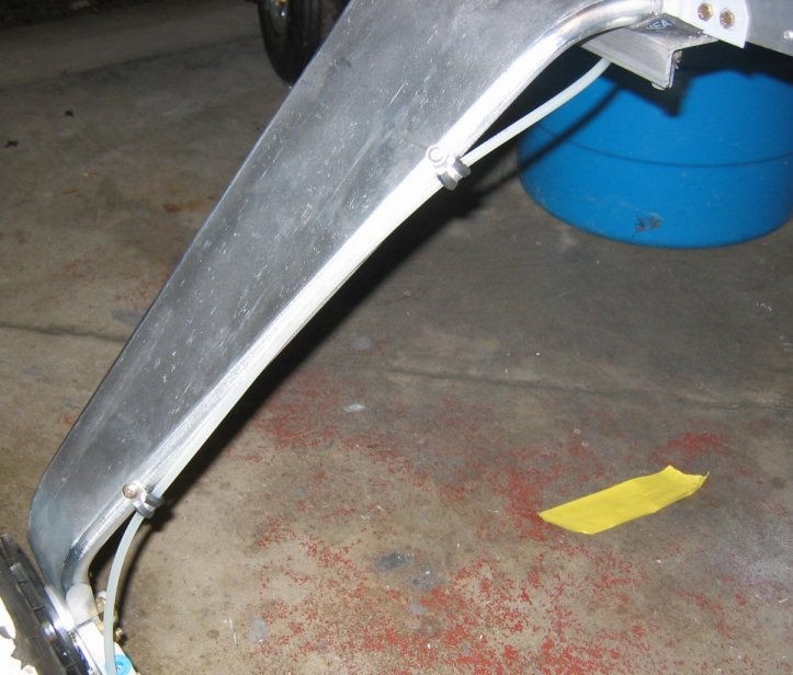

PostPosted: Mon Sep 13, 2010 12:11 pm    Post subject: Re: Brake line clips Reply with quote
Jim,
Adel clamps may be kludgey, but they stay. I have pictures of the ZAC demo 601XL from both 2006 and 2008 where it is obvious the self-adhesive clips come off with regularity and new ones were re-applied.
An archive search should find where someone made a trailing edge sleeve out of aluminum that encased almost all the brake line run. I remember where someone just used 600 MPH tape and basically did the same thing.
I am currently flying with the adel clamps and am happy with them.

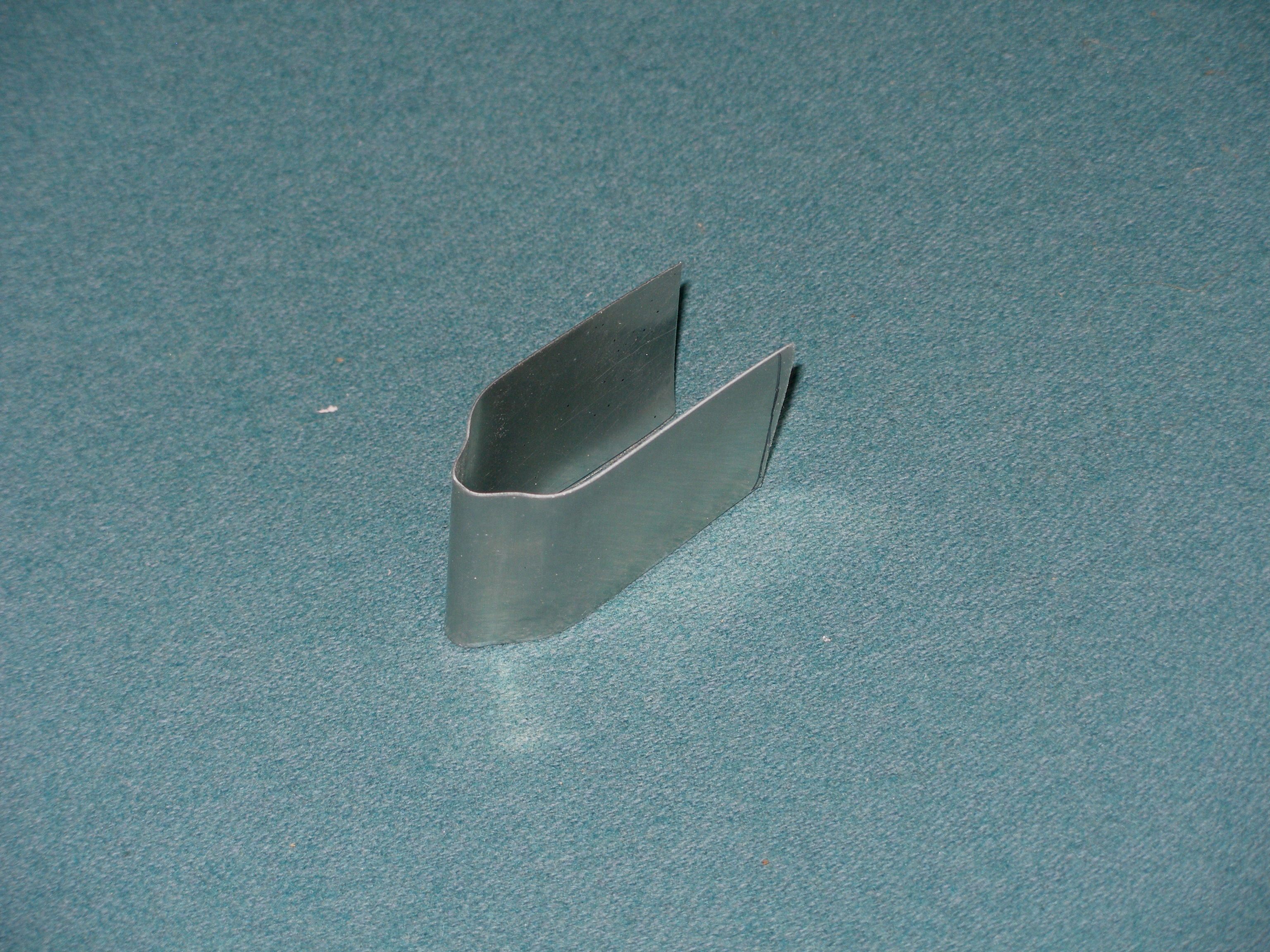

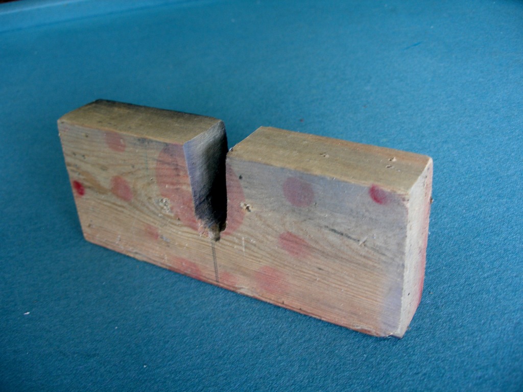

PostPosted: Mon Sep 13, 2010 1:24 pm    Post subject: Brake line clips Reply with quote
Jim,
I used "home made" clips from .016" 6061-T6. I made a female form in a 2 x 4 and pounded the aluminum strip into the form with a long bolt shaft into the brake line bead, then with a larger pipe for the gear leg part. The photo is a crude one I just made to give you an idea what I am talking about. I used three per gear leg. I originally applied them with JBWeld, but that didn't last long. I re-applied them with a regular epoxy and they stayed on.
Jay Bannister
