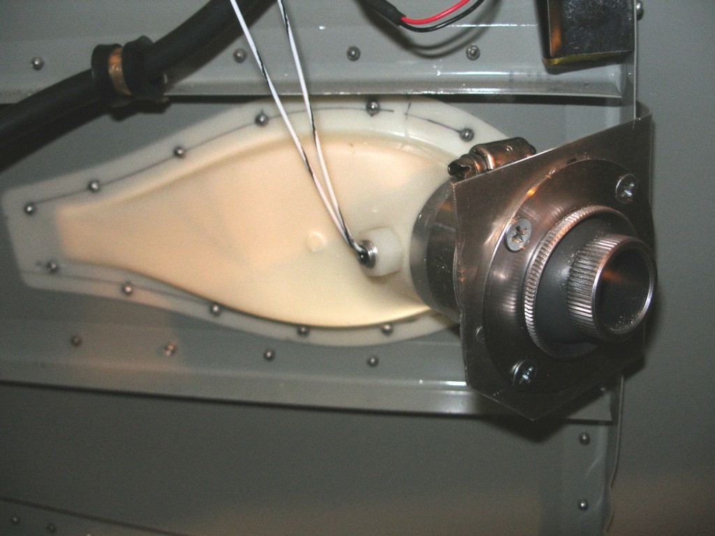

PostPosted: Sat Oct 29, 2011 4:59 am    Post subject: Dynon OAT probe location Reply with quote
Chris,
That seems the ideal location to me. Here is a photo of mine.
Jay

PostPosted: Sat Oct 29, 2011 6:38 am    Post subject: Dynon OAT probe location Reply with quote
Chris,
That is a popular location and works well. Mine is under the fiberglass saddle on the tail. It is in the open air and still not in direct sunlight. That works well too but the wires are longer.
Jeff D

PostPosted: Sat Oct 29, 2011 6:49 pm    Post subject: Dynon OAT probe location Reply with quote
I installed one in a little aluminum tube that stuck out of the bottom of the wing stub.  I filled the end of the tube with flox, and drilled a hole in the front of the tube, so that the free airstream could get to the probe.  I think the cabin air vent would work nice too.
