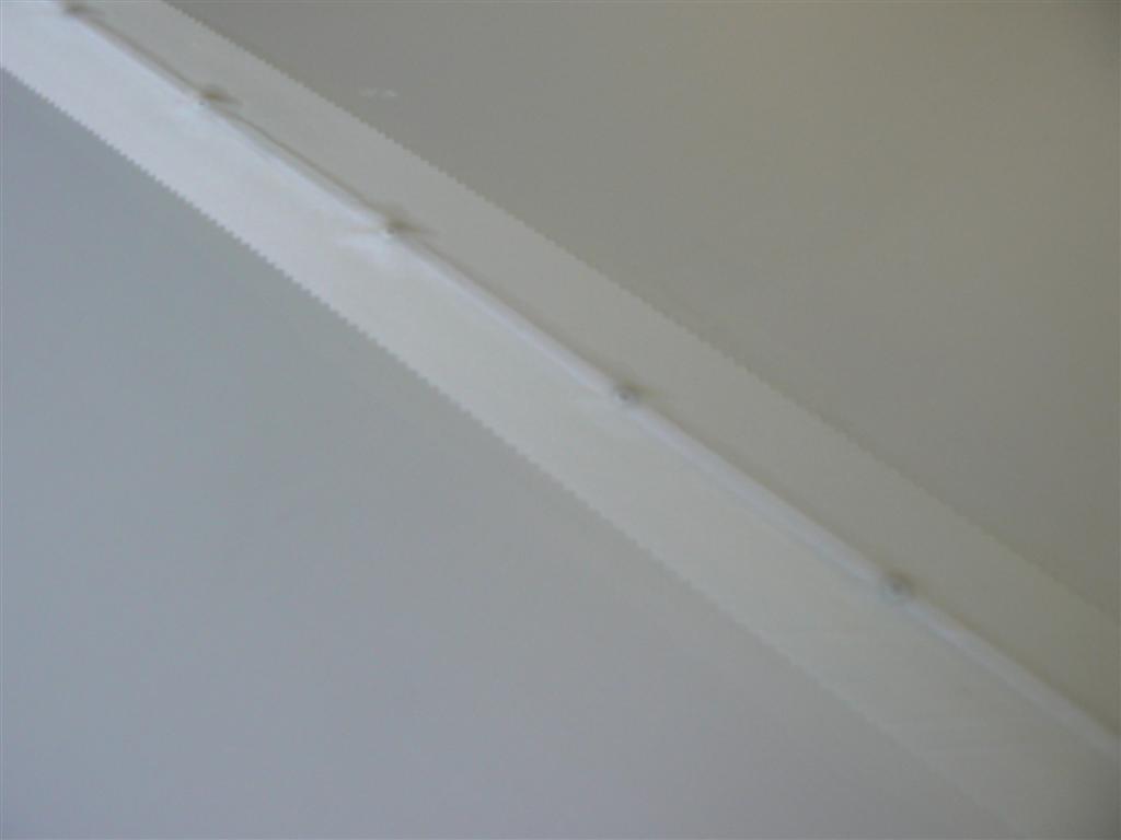

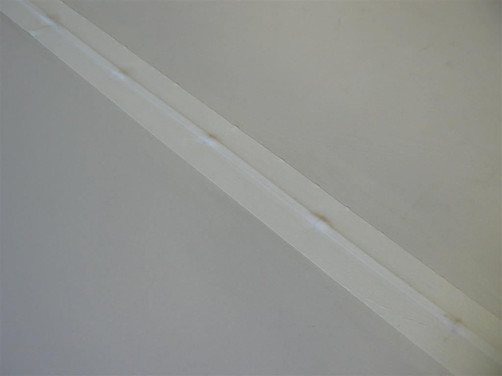

Here are pictures comparing two adjacent ribs, one the riveted tip rib, and one stitched, the finishing tape has not yet been ironed. Judge for yourself which one creates more of a pucker, bump or whatever.
Richard,
I noticed that the first picture showed pinked edges on the finishing tape, while the second picture showed straight edged tape. Are these on the same plane/wing?
Bill Varnes

PostPosted: Thu Jul 22, 2010 6:03 am    Post subject: Re: Rib Stitching Reply with quote
[quote="WhiskeyVictor36(at)aol.co"]In a message dated 7/21/2010 12:41:05 P.M. Eastern Daylight Time, richard(at)bcchapel.org writes:
Richard,
Bill Varnes
Original Kolb FireStar
Audubon NJ
Yep. I wanted to use bias tape on the final outboard rib, as the fabric at the front drops off at a fairly steep angle, and the straight tape would wrinkle badly. Unfortunately, the only bias tape I have has pinked edges, so it will be slightly different from the rest of the tapes, but I don't think it will show much after it is painted.
Good catch.
