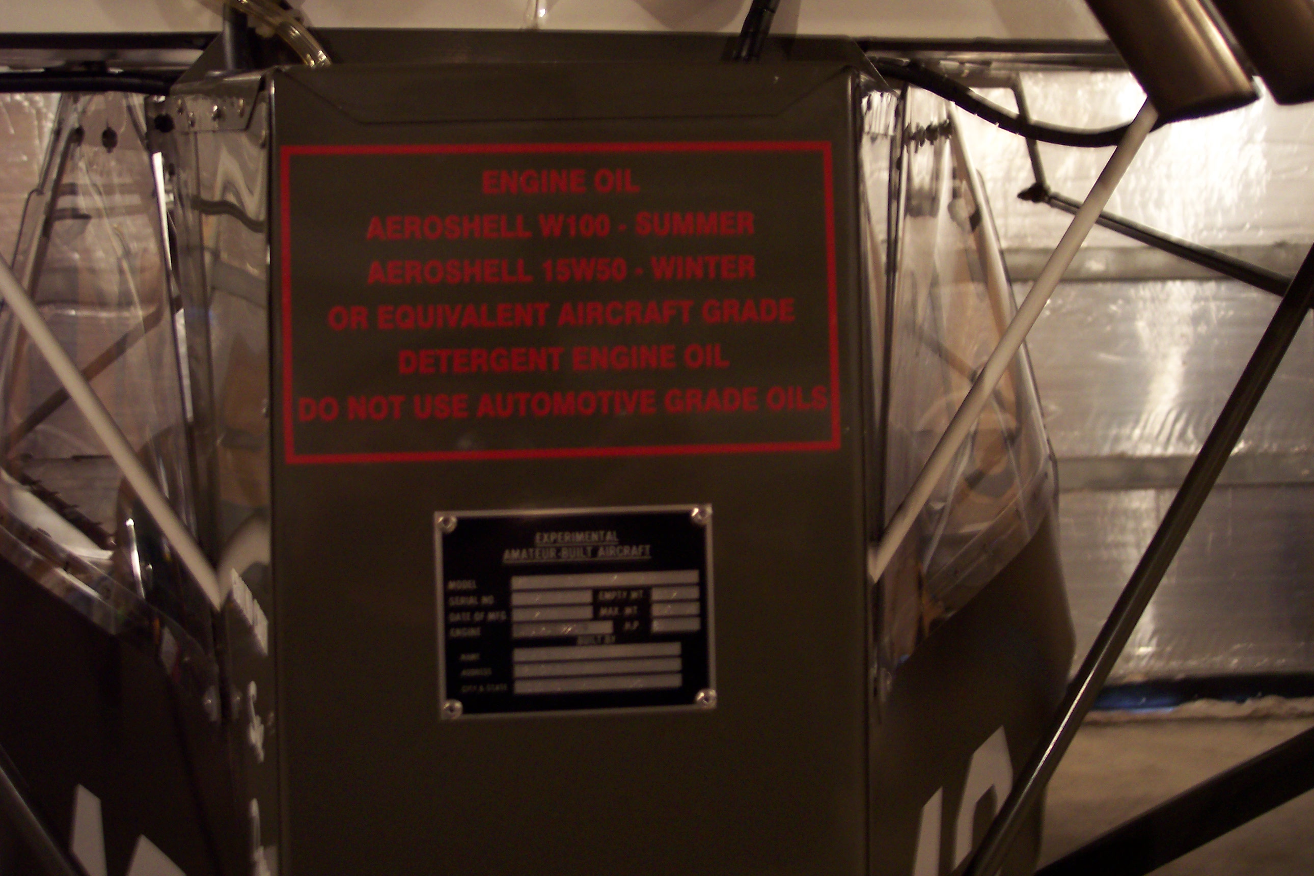

PostPosted: Tue Nov 09, 2010 6:18 pm    Post subject: Re: Mark III Data Plate Reply with quote
My inspector didn't care as long as it was on the out side of the aircraft...mine is at the tail of the fuselage..
chris ambrose
M3X/jab
n327CS

bill_joe(at)bellsouth.net
PostPosted: Tue Nov 09, 2010 6:53 pm    Post subject: Mark III Data Plate Reply with quote
In my case the inspector said the reason the manual calls for it to be
somewhere in the tail section is because in a lot of crashes that is the
only thing left in case of fire or something like that. Bill
