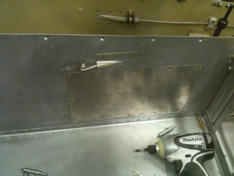

Deems Davis
Posts: 925
PostPosted: Mon Jun 14, 2010 2:51 pm    Post subject: Center Tunnel Reply with quote
FWIW
I fabricated and installed the side tunnel access door for servicing the fuel pump/filter. http://deemsrv10.com/album/Sec%20The%20Home%20Stretch/slides/DSC05413.html I don't think I'd do it again if I had to. The reason, is that there's so much stuff in the tunnel that you want to check and inspect during the condition inspection, that really requires you to take the tunnel cover off. I haven't had the need/opportunity to get inside for anything else, and it was a fair amount of work to fabricate and install. In my case it requires removing the center console that sits on top of the tunnel, and I still think its better to remove the tunnel cover. I DID split the forward tunnel cover into 2 pieces, http://deemsrv10.com/album/Control%20Approach%20Rudder-Brake%20Pedals/slides/DSC06591.html and I WOULD definitely do that again.
I removed and cleaned my fuel filter during the last ACI and with the andair fuel selector turned OFF and some paper towels placed under the fittings. I didn't have any leakage into the bottom of the tunnel. YMMV
Deems Davis
N519PJ
www.deemsrv10.com

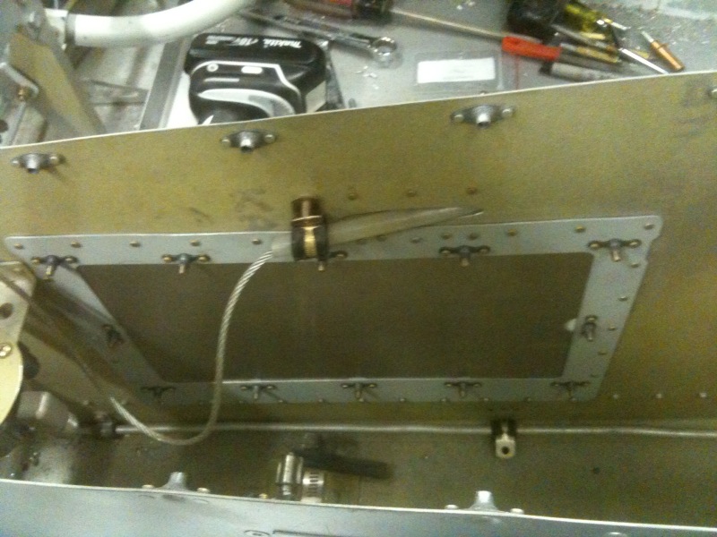

rnewman(at)tcwtech.com
PostPosted: Mon Jun 14, 2010 5:47 pm    Post subject: Center Tunnel Reply with quote
Although not flying yet, here's my tunnel access that I made. I changed from carburated to fuel injected so I had to change my fuel pump. I went to the andair pump and decided to move the filtering out to each wing root via an andair gascolator. So I have no filter to be changed in the tunnel, my access panel is intended for inspection purposes and possible pump servicing if necessary. Like Deems I have a center console that I really don't want to have to remove to get to the tunnel, so I'm hoping to carry out inspections via this panel, perhaps with the aid of borescope type video camera.
Bob Newman,
www.tcwtech.com
40176.
http://picasaweb.google.com/rcnewman64/FuelPumpAndAccessDoor#
Strasnuts
Joined: 10 Feb 2009
Posts: 502
Location: Salt Lake City, UT
PostPosted: Mon Jun 14, 2010 8:59 pm    Post subject: Re: Center Tunnel Reply with quote
Here is my AndAir install.
 Filesize:  134.85 KB
 Viewed:  7122 Time(s)
 Filesize:  110.52 KB
40936
RV-10 SB N801VR Flying
780 Hours
SuperSTOL 60 hours
Strasnuts
