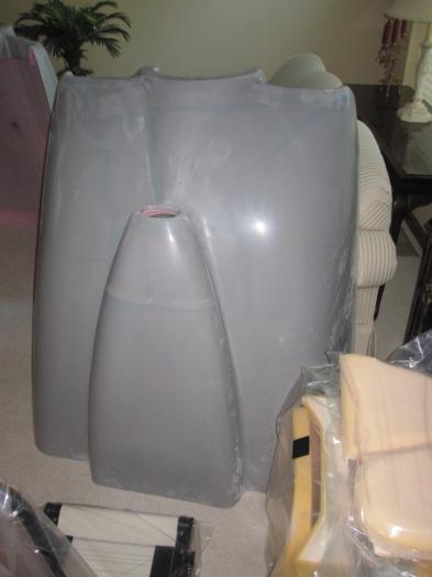

My finish kit arrived yesterday. I was surprised by the gray primer on the cowl. I guess that’s something new Van’s is doing these days.

Looks like a nice get coat. Shucks we can’t make comments about your pink plane.

Not sure if this is the same, but the more modern composite plane manufacturers are spraying a coat of primer into the mold before the layup/cloth or pre-preg is laid in. This is not a gel-coat (gel coat is polyester based and won’t stick to a pure epoxy matrix), but is instead a primer layer. Having it be the first layer in the mold layup does many things: 1) pre-primes the part for the builder J, 2) pre-fills the pinholes in a way that won’t allow them to reappear later J J, 3) provides a sure bond between the primer and epoxy matrix since the epoxy cures to it.
If this is what Van’s is doing now – great!

I wonder if Vans has changed vendors for the cowl. I am generally pleased with the kit, but I thought the QC on the cowl was lacking.

I thought the QC on the cowl was lacking<
Spoken like a builder that hasn't worked with the canopy yet! Talk about
crappy fiberglass. I would definitely pay extra for much more finished
glass parts. I decided to paint my interior canopy vs. headliner and it
takes a lot of filler and sanding to get the canopy paint ready inside &
out.

Item #2 is not necessarily true, you just might not be able to see the pinholes and larger void, but that doesn't mean they aren't there.
The Nomex, honey comb sandwich material in the cowl certainly can allow for huge voids where the edge of the honeycomb is keeping the first layer of glass against the mold, but the area in the middle of the cell structure allows the glass to come off the mold, thus the alligator scale like skin.

Robin: Actually my cabin is done; I thought the QC on the cowl was worse. The cabin area issues were cosmetic; the cowl issues structural. The foam/glass reinforcement was placed too far aft. I had to remove some, and then reinforce what was left.
