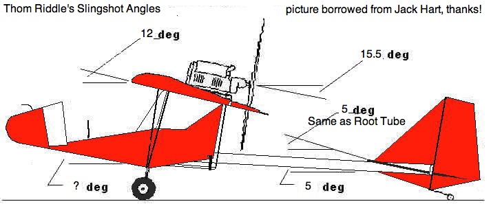

  A couple of things NOT offered so far are your wing's incidences, compared to your horizontal stabilizers incidence.
  The greater the difference between your main wing's incidences and your tailfeathers incidences, the more you main wings will "plow" through the air. (meaning---serious drag!!!!)
  When I did quite a bit of MkIII incidence research last year, I found some significant disparities between some of the MkIII's wings' incidences.  Example;  one guy "reports" as much as 2.5 degrees difference between his MkIIIX and the other MkIIIXs' wings vs hor stabs.  That's a lot!!
  Obviously, if in fact he is correct about his 2.5 degree difference with the other's angles, then his plane will fly VERY different than theirs will (either faster or slower).

Speaking high thrust lines, wing incidence and HS incidence, I am wondering if the numbers on my SS are "correct". I will call Kolb and ask but thought maybe someone on the list might know what the design calls for on the SS. Attached is a drawing I borrowed from Jack Hart and edited the numbers to match my SS.
It seems to me that the difference between my wing incidence and HS incidence (7 degrees) is greater than it should be, but this is just a guess. It also seems to me that my thrust line angle is way too high (3.5 degrees pointed up relative to wing bottom, and 10.5 degrees above HS incidence).
Any thoughts from those who know would be appreciated.

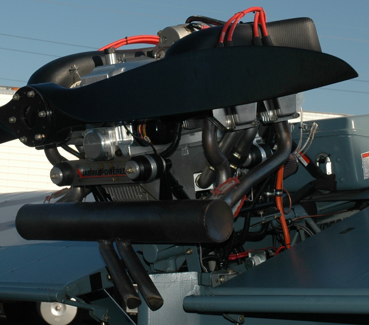

My mounts are very hard rubber and the engine does not appear to move much at all when tied down and run up. Unfortunately, the wet sump on the Jabiru is pretty deep which requires a fairly high mounting. My prop (only 64" diameter) clears the boom tube by at least 5-6" at rest.
My question for you (and/or others) is this. The static (at rest) thrust line of the my engine is pointing upwards 3.5 degrees relative to the bottom of the wing. Is this about right, assuming my mounts are plenty hard? Note that the axis of the motor mount bolts is not vertical like on the Rotax but parallel to the longitudinal axis of the airplane. However I can still raise one side/end vs the other because this mount bolts to the Kolb engine tube. Not sure this shows in the attached photo, but that is all I have right now and my camera keeps quitting on me. Guess it is time for a new one.

Yes, as a guesstimate 3.5 deg sounds about right.

not sure about the sling shot..... the bottom of the mkIII wing has 9 deg positive incidence in flight. if I read your post correctly you would add 3.5 deg to that, assuming the SS has the same 9 deg in flight (plus or minus), adding the 3.5 would make the front of the engine pointing up at 12.5 deg in flight. guess I am going to have to measure my mike this week... guess in my mind I would think the engine should have less incidence than the bottom of the wing. making the prop more perpendicular to the line of travel.
or am I missing something?

That is my thought too. I would think that at cruise, the thrust line should be fairly closely aligned with the relative wind.
BTW, I measured the angles again yesterday and came up with a little different numbers but still seems the thrust line is pointing too far up. The reason for the difference in measurement was I used the prop hub this time instead of the top of the engine.
My Slingshot wing bottom chord has an incidence of 7.5 degrees relative to the boom tube and horizontal stabilizer (parallel to boom tube). The thrust line (static) is 9.5 degrees relative to the HS & boom tube, so the engine is point up only 2 degrees rather than 3.5 degrees. But it still seems to me that it should be more aligned with relative wind at cruise AOA.
If my SS flies at cruise with an AOA of 7.5 degrees (guess) then the thrust line (very hard mounts so not perceptible tilting under power) is not parallel to relative wind by about 9.5 degrees.
ON THE OTHER HAND...
Perhaps this is by design to help offset the effect of the high position of the thrust line. Still waiting to hear back from Travis on this question.
