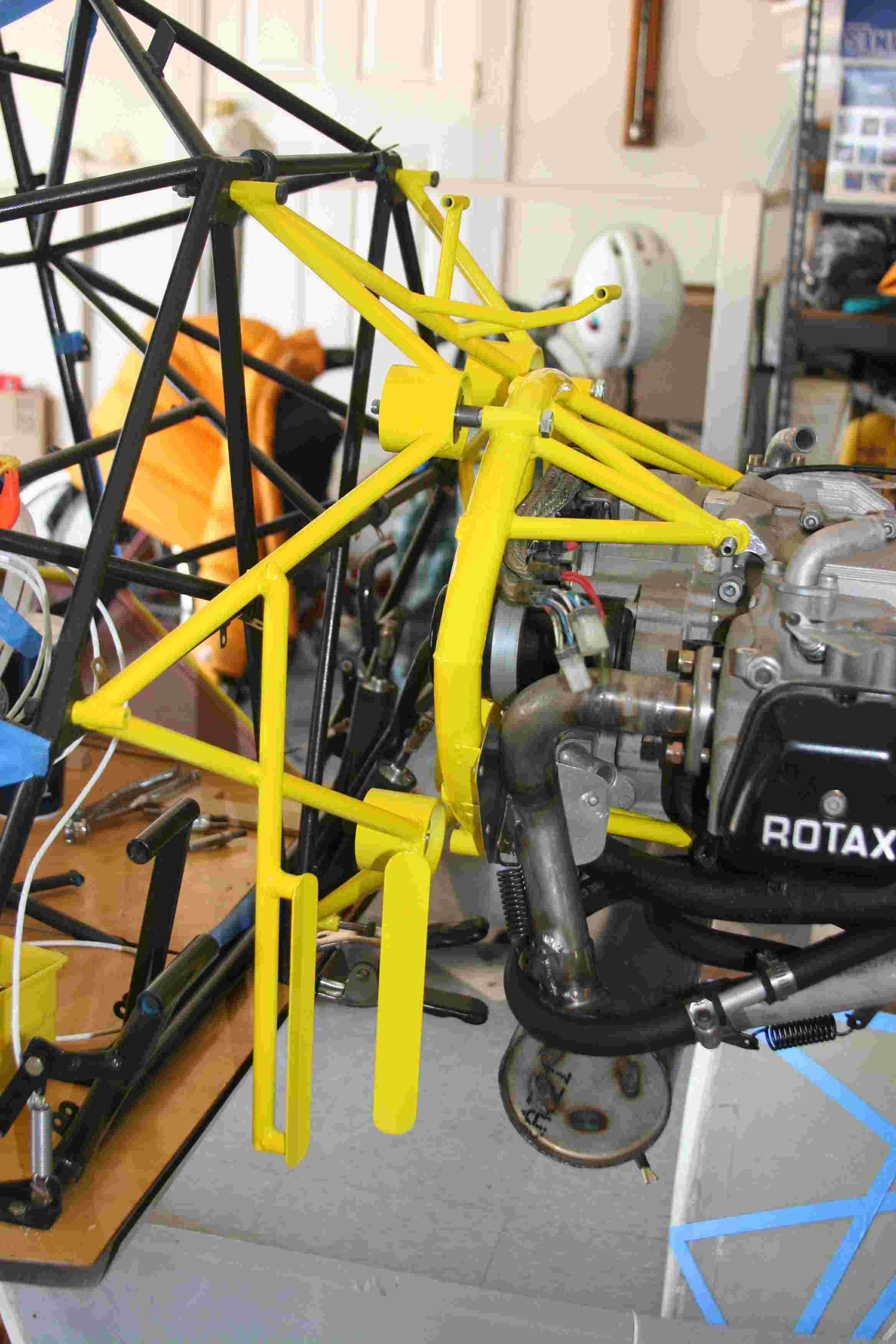

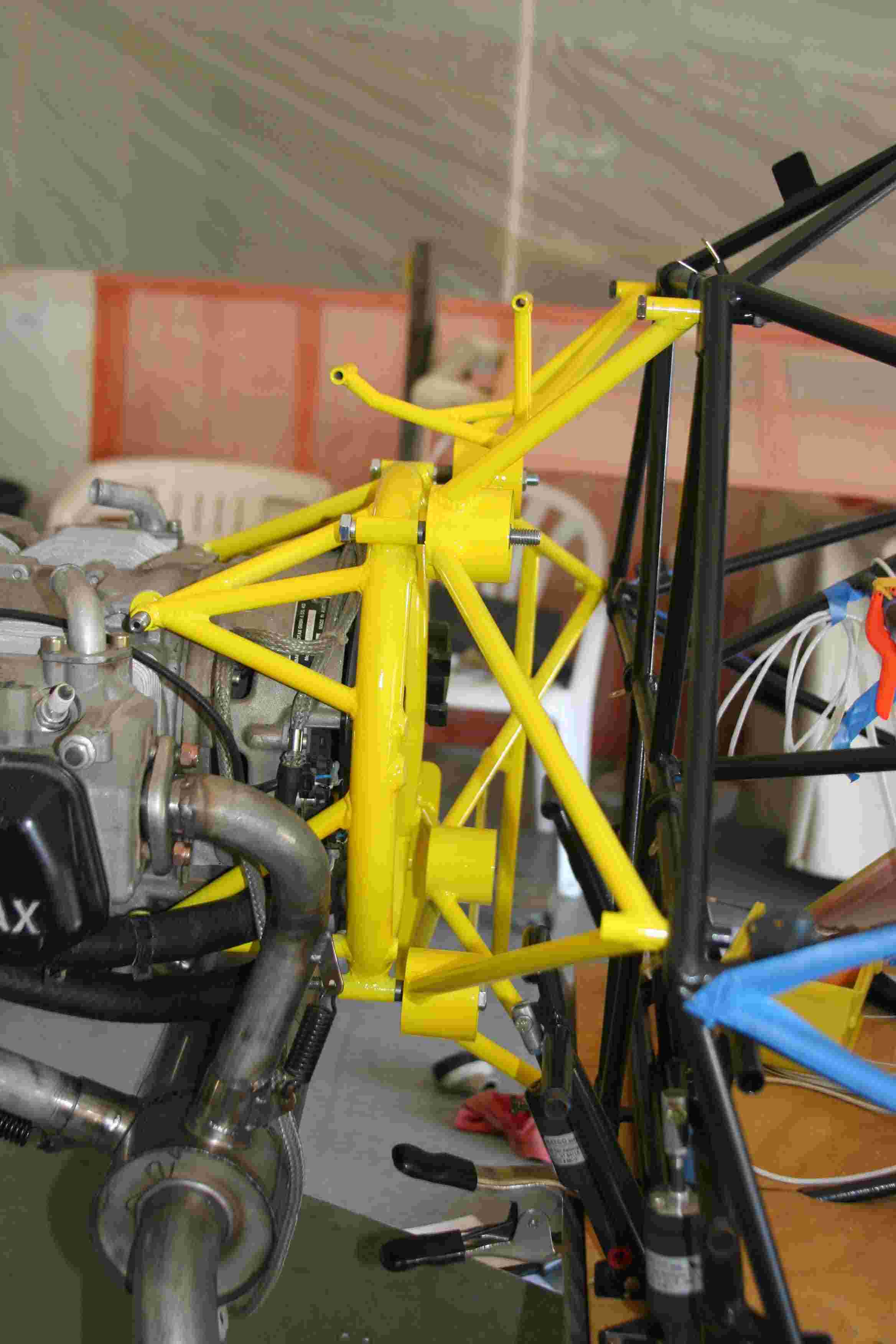

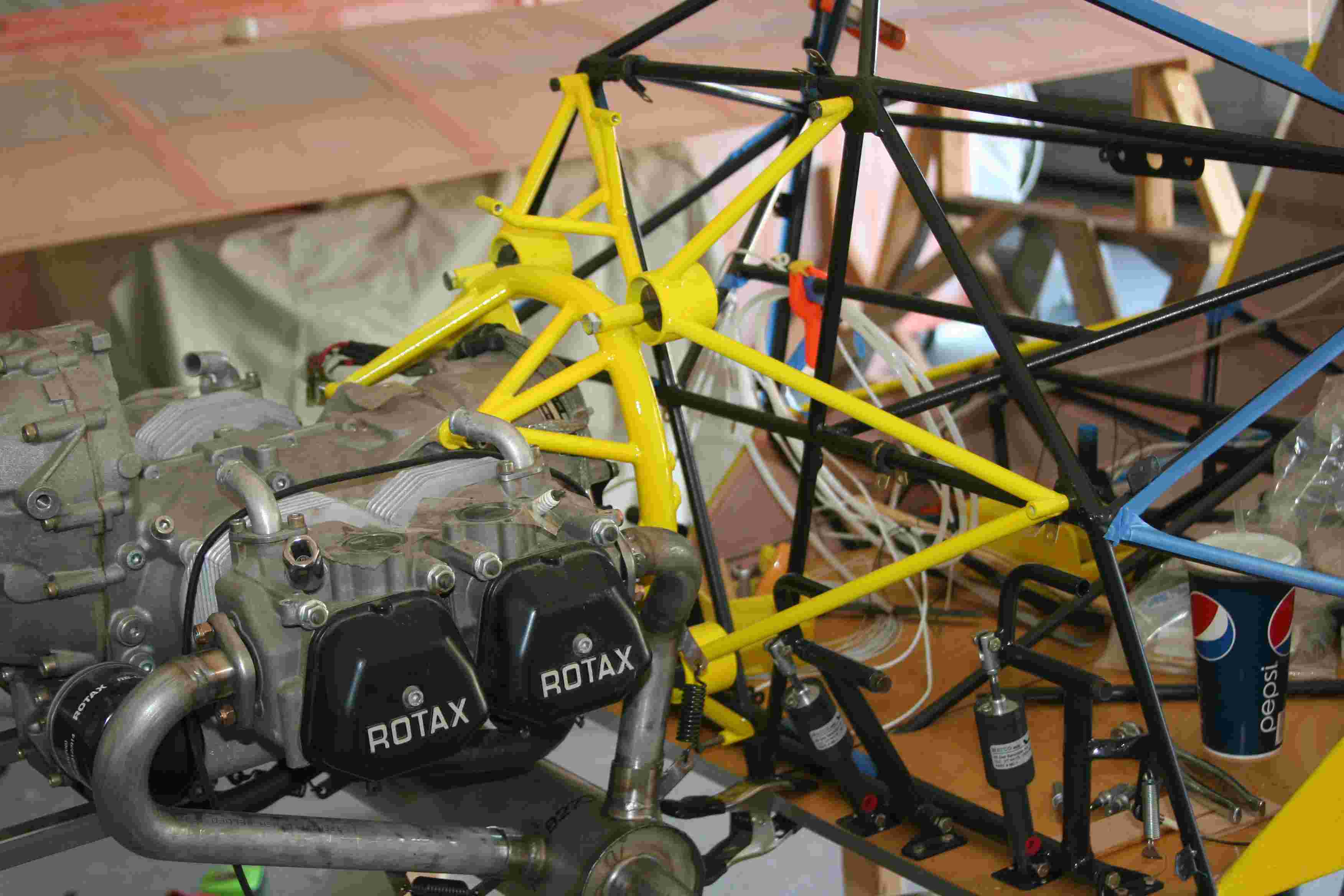

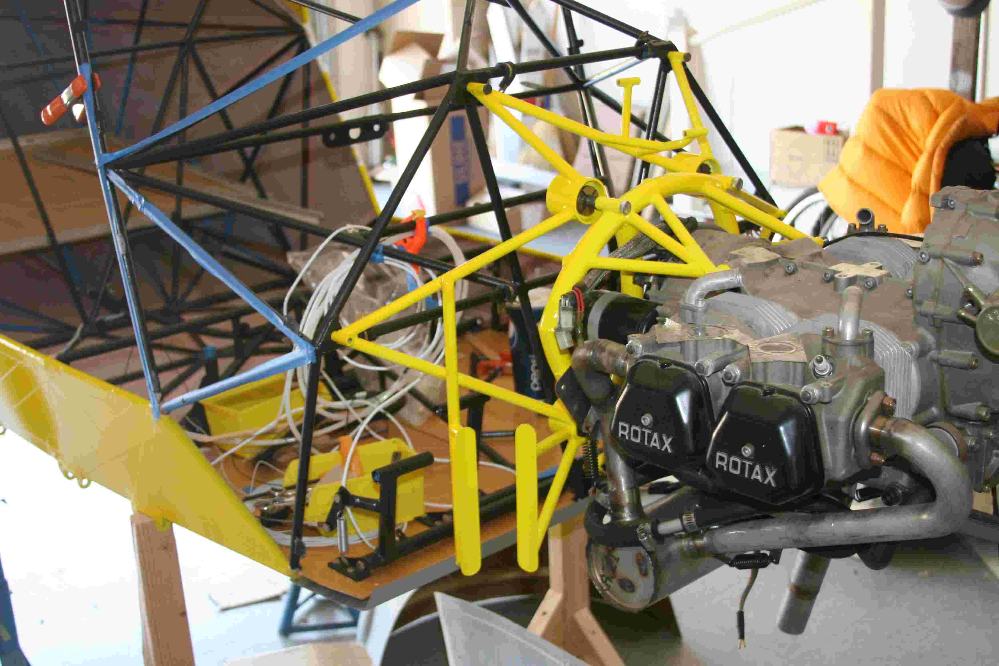

I thought an update on the engine mount. It is installed and bolts
tightened. I was surprised that while fitting the cowl, the oil tank needed
a bit of surgery. I was thinking of cutting a corner off the bottom and
having a welder weld it up again. I noticed a small dent on the bottom
corner and it gave me the idea that I might be able to do a little body and
fender work on it to get it to fit. I did exactly that and used some micro
and epoxy to smooth it out and then painted the bottom bowl my finish color
to hide the fix.
I am making the donuts, but I had two miscasts so only have four to date. I
think I still have enough of the rubber for the remaining four. I used the
light weight engine stand from Harbor Freight. I made a jig that mated to
it and if you would like it, I can send it down. It allows for two axis
alignment - pitch and bank. I did weld the rotating tube in the stand for
stability. I also found some cone shaped things that I used to locate the
donut rings while welding. You can have those as well. They won't burn up
with the welding.
Photos attached.
Lowell
