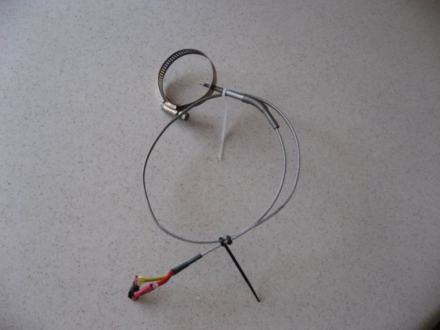

Changed the EGT probe on #2 today. This is the second time to replace #2 EGT probe. Note the black shrink wrap near the connectors. These are the cheaper probes from GRT. Note that I did not say inexpensive.; the price from GRT is about $10 less than their "higher quality" probe. I did not know this when I received and installed my EIS 6000. They are not inexpensive because in 278 hours I have had four failures using these probes. Each time a failure occurs, the aircraft must be uncowled and a part obtained from GRT. Each failure cost about 2 hours of my labor and acquisition and AOG freight charges to remedy. If you use GRT probes at least insist on the EGT probes with the white shrink wrap near the connectors; they are the "higher quality" probes.

I have now replaced all six probes after 650 hours of flying.
If you have not flown I would return everyone of them and get the higher quality probe that GRT offers. So far, no problems with them.

I've been following this with interest because I've been
flying 625 hours now with only one probe failure on
the same probes, in fact the black labeled ones. In
fact, the failure I had was due to the crimped end.
I've removed them twice or so, when I removed the exhaust,
and reinstalled. I'm not sure why mine have been
reliable, but they have been.
Tim Olson - RV-10 N104CD

PostPosted: Mon May 17, 2010 5:02 pm    Post subject: GRT probes Reply with quote
Bob, Sandy just mentioned that they offered a higher temp option when I called the first time. And $10
I am not sure why I have had probe problems Tim and you have not. I do have ceramic coated exhaust that may store more heat inside the system. I also located my probes as close as the plans discussed to the cylinders (I think that was 2.5").
If I did it again I would probably locate them further down the exhaust, maybe that would make the difference. The new probes appear to fix the problem as I have not had one issue with them.
I also have some skin friction heat caused by the speed of my plane that increases the heat of the exhaust. That is most likely the problem Smile

PostPosted: Mon May 17, 2010 5:13 pm    Post subject: GRT probes Reply with quote
I think mine are 2" or so. When mine do go bad I'll just get 6 new ones and the good ones then. But for now I'm a happy camper.
I think you're right about the skin friction heat....that's the hot tunnel reason too. Have you noticed your wing leading edges glow slightly orange at night too?
Tim
