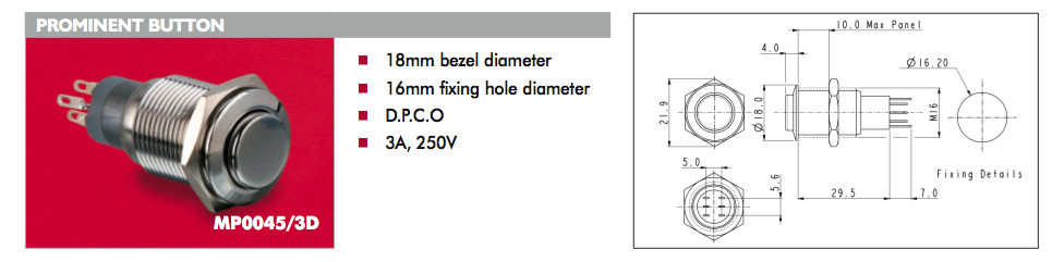

This switch OK?
johngoodman
Joined: 18 Sep 2006
Posts: 530
Location: GA
PostPosted: Mon Mar 01, 2010 7:24 pm    Post subject: This switch OK? Reply with quote
I'm looking at using this switch - will it work in a 14v system?
John
 Filesize:  135.77 KB
 Viewed:  34310 Time(s)

PostPosted: Tue Mar 02, 2010 6:55 pm    Post subject: Re: This switch OK? Reply with quote
John,
Yes, it will work. Voltage is not an issue for this switch in your airplane. Current is the issue. The picture does not specify 250V AC or DC. I will assume that it is AC. I think it should be safe to use this switch to handle up to 5 amps at 14VDC. A switch will not immediately self-destruct if operated slightly above its rating. But its life will be shortened. How much current do you want to control with this switch and what type of load is it?
Joe
Joe Gores

PostPosted: Wed Mar 03, 2010 5:05 am    Post subject: Re: This switch OK? Reply with quote
Joe
I want to use it for Coil Power for a GearedDrives LS1 V8 engine in an RV-10. I'm not sure what the Coil actually draws but the wire is protected by a 15 amp fuse. The wire from the engine looks like a 14 or 16awg. I'll have to look into the actual draw, but this switch will probably not work since I need reliability. Thanks for the reply,
John

PostPosted: Wed Mar 03, 2010 3:28 pm    Post subject: This switch OK? Reply with quote
John,
Reading your reply to other folks replies I am concerned of your
using this switch for your intended application.
First off, the switch information you provided in the attachment does
not designate if it is rated for AC or DC current. Note, an AC rated
switch if used in an DC current application, the DC current capacity
will normally be only a fraction of it's AC current rating. Second,
I would point out that the reply by Joe saying that you could
probably run 5 amps of current exceeds the switches current rating,
if it turns out to be an AC application switch, you would be further
outside the switches safe operating limits. Neither would be
acceptable solution.
I strongly recommend you determine your current needs for the circuit
your controlling. Then determine if the switch your considering is
AC or DC rated. If the switch is AC rated, find another switch
appropriate for your application. Do it right the first time, you
might not get the second chance to do it over again.

PostPosted: Wed Mar 03, 2010 4:55 pm    Post subject: This switch OK? Reply with quote
What coil? Ignition? The picture I saw appears to
be a momentary push button. If it has 3 terminals,
then I suspect it's a single-pole, double-throw
device. Further, push-buttons of this style are
slow-make, slow-break (no fast acting over-center
mechanism). VERY poor technology for switching
reactive DC loads.
user9253
Joined: 28 Mar 2008
Posts: 1978
Location: Riley TWP Michigan
PostPosted: Wed Mar 03, 2010 6:21 pm    Post subject: Re: This switch OK? Reply with quote
Looking at the picture of this switch (made in UK), the first thing that came to mind is that it was going to be used for a starter switch. It turns out that John intends to use it for a more critical application where a high quality switch should be used. So I take back what I said about the switch being ok to use.
As a general rule, a 125VAC rated switch can handle the same current at 14VDC, even if the manufacturer does not publish the DC rating. Every AC switch has a DC ampacity. That ampacity might not have been determined by testing and thus is unknown.
Jerry B. said,
"the DC current capacity will normally be only a fraction of it's AC current rating."
That is true if the voltage remains the same: 250V in this case. But, generally speaking, a 125VAC rated switch can carry as much DC current at 14V as it can carry AC current at 125V. An example of this can be seen by reading the data sheet for another switch. http://www.nkkswitches.com/pdf/stoggleslowcap.pdf
Notice that 125VAC rating is identical to the 30VDC rating. At 14VDC, this switch can handle even more. Also notice that this switch can handle 2 1/2 times the current at 30VDC than it can at 250VAC. Most good quality snap action AC switches are suitable for use in homebuilt aircraft as long as the 14VDC current does not exceed the 125VAC rating of the switch.
Comments are welcome.
Joe
Joe Gores
fvalarm(at)rapidnet.net

If this switch is going to kill the engine, what will happen if the switch fails while flying? Assuming that you have two ignition systems, there should be one switch for each. Is that what you have planned?
Joe

PostPosted: Thu Mar 04, 2010 11:49 am    Post subject: This switch OK? Reply with quote
John
If like many of us here you looking for more than just a yes or no
answer, you might consider that most of us running EFI
systems do not cut ignition power to kill the engine. (I'm assuming you
have EFI) That leaves fuel in the cylinders and (same as a Lycoming) can
be a safety hazard if someone moves the prop on a hot engine. Most EFI
computers will kill the fuel before the ignition.
The next preferred shutdown method would likely be to kill power to the
electric fuel pump(s). That is what I do when I taxi in on my backup EFI
system. Anything other than a normal system shutdown can set engine
codes on some computers though.
I do control power to my secondary ignition coils through a toggle
switch but I never shutdown the engine that way.
Ken
johngoodman wrote:
<johngoodman(at)earthlink.net>
I guess some explanation is in order, sorry about that. I'm looking
for a unique switch for Coil Power for my GearedDrives LS1 engine.
The panel has a VP200 and no other switches except two battery
switches that look just like the VP200 switches (autopilot does have
a couple of micros). The reason for a Coil switch is that I need a
quick way to kill the engine. There is no key, and the VP takes care
of starting. Otherwise I would have to remove power from the battery
busses to stop the engine at the end of the flight. This would kill
everything at once, unless I did some power isolation first. So, I'm
looking for a Latching Pushbutton, preferably lit when on. It needs
to be obvious to the passengers that it powers the engine. In
reality, I think it only draws about 3 amps, 5 at most. Think of it
as the "run" position of your keyed ignition. Hope this helps. John
-------- #40572 QB. Engine on, wing attach coming soon. Panel
delivery soon. N711JG reserved
ulflyer(at)verizon.net
PostPosted: Thu Mar 04, 2010 6:47 pm    Post subject: This switch OK? Reply with quote
Whoa there Joe,
Wow! Can't believe your saying using use AC rated switches for DC
applications at near the full AC current rating is OK. No way.
AC switches take advantage of the AC zero crossing for reducing
contact arcing and welding. (The reason DC switches amp for amp
typically cost more than AC switches, there made different to reduce
and eliminate contact arcing and welding.) And suddenly you say
using the switch the gentlemen asked about is OK and justify your
recommendation upon the spec's of a totally different switch. Use
the right type of switch for your application. Maybe you can
convince the folks that select the switches used for DC powered
landing gear applications to use AC designated switches. Just don't
think you'll quite sell them on your method.
jerb
Jerry B. said,
AC current rating."
Joe

PostPosted: Thu Mar 04, 2010 6:53 pm    Post subject: Re: This switch OK? Reply with quote
Sorry that I've got everybody wondering; I'll try to explain.
The GearedDrives LS1 Corvette engine is just like a car. In a traditional car, the key has several positions, the last rotation is "start", and it is spring loaded to come out of start to "run." The "run" position is Coil power. It is not actual Coil power which is a lot of juice, just a relay out "under the hood." When you turn off a car, you don't starve it of fuel like airplanes normally do, you kill the coil power.
As far as my switches, The VP200 does everything with soft switches and it's switch panel. The Master Battery and Aux Battery switches are positioned next to the switch panel and are the same brand of switches. The two fuel pumps and the Engine Crosstie will be on three guarded switches on the console, under the panel, that will be normally on. See Z-19 but add a crosstie between the two batteries, put the engine battery bus on the "on" side, but leave the Keep Alive power for the ECU on the engine battery hot side.
There shouldn't be fuel in the cylinders because the ECU won't inject any and the fuel rail regulator is closed. The prop is not connected to the engine because the clutch has released around 700 rpm. You can spin the prop all you want. Fuel is still pumping but isn't getting past the Filter/Regulator which returns all the fuel to the tanks. Fuel can be stopped by turning off the batteries or opening the guarded pump switches.
I'm sure a lot of you think this is wrong, but I'm really not asking. I'm only trying to find a good Kill Switch that is so obvious that even a Cave Man Can Do It.
I'm still amazed that a guy steered a stuck pedal Toyota for 6 miles without ever thinking about the shift stick or the key....
John

user9253
Joined: 28 Mar 2008
Posts: 1978
PostPosted: Thu Mar 04, 2010 8:36 pm    Post subject: Re: This switch OK? Reply with quote
Wow! Can't believe your saying using use AC rated switches for DC applications at near the full AC current rating is OK. No way.
JERB,
I am not the only one who thinks that it is OK to use AC rated switches in airplanes. Read the last paragraph on Page 2 and page 3 of this document written by a well respected electrical guru,
http://www.aeroelectric.com/articles/Switch_Ratings.pdf
Here is a quote from that article:"
In a nutshell, 125 VAC ratings equate favorably and conservatively to 14 VDC ratings - as long as the switch has a healthy "snap" action . . .The switches we stock sell for $5.00 in a single-pole device and carry no markings for DC ratings. They are rated at 7 amps or better at 115 AC and will work just fine in virtually every slot on an airplane panel."
Joe Gores
PostPosted: Thu Mar 04, 2010 9:41 pm    Post subject: This switch OK? Reply with quote
All switches have ac and dc capabilities at some level.
Just because the ratings on the printed on the side of
the switch are given at 120 or 240 VAC simply speaks
to the largest market into which they are sold. It
doesn't mean that they don't have useful and quite
rational application in DC systems. The comparative
ratings charts for switches in any well written
switch catalog will confirm this assertion.
The voltage rating of a switch is driven mostly by
it's ability to break a circuit . . . spread the
contacts fast enough so that the fire goes out
before damage is done. The intensity of that fire
is proportional to the current in the circuit at
the time the contacts open.
So a switch with contacts that don't overheat at
7A will CARRY that much current at any voltage but
the current may have to be de-rated at the higher
DC voltages . . . because it's harder to put the
BREAK the circuit without generating a lot of heat.
