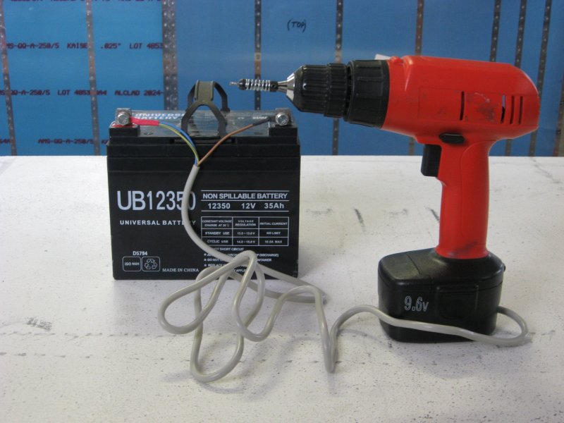

PostPosted: Tue Mar 02, 2010 4:43 pm    Post subject: Battery charging Reply with quote
BobsV35B(at)aol.com wrote:
[snip]
I find that some batteries do fail the test before I would have normally
replaced them. As Jim mentioned. I try to use those batteries in a garden
tractor or similar non critical application.
Me too, Old Bob <g>. (Image of my drill with an external 35AH battery
attached). Seriously, this is a cost-effective substitute for those
expensive replacement NiCad battery packs. I just can't bear to throw
away even a Harbor Freight $20 drill motor and it very useful at times.
The fine print: yes, this is a 12V battery and a 9.6V drill fed with
some 18AWG power cord I had lying around. The drill motor likes it just
fine. The thing should be fused but I consider the entire power cord to
be a "fusible link".
Joe
