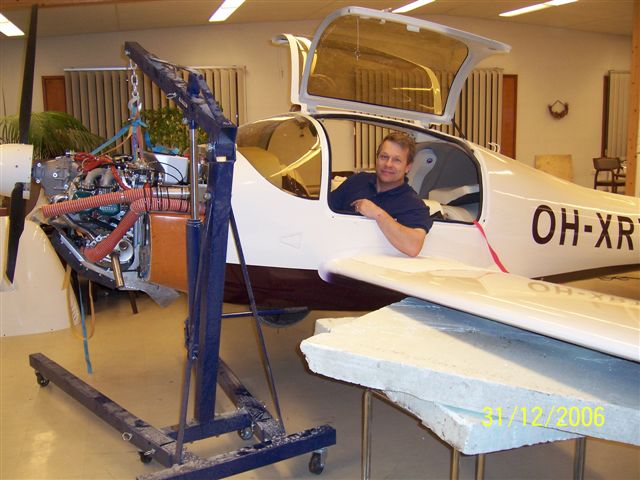

raimo.toivio(at)rwm.fi
PostPosted: Mon Feb 01, 2010 3:29 am    Post subject: Lifting the Europa Reply with quote
Like this? This is how I have done it and will do.
I use four lifting straps all capable for +200 kgs.
Notice 1: the wings are supported only just to keep the plane stable sideways, not to take weight.
Notice 2: what more you lift that more you stress the tail wheel (if the tail is not supported /lifted).
Raimo OH-XRT
 Filesize:  64.85 KB
 Viewed:  8233 Time(s)
