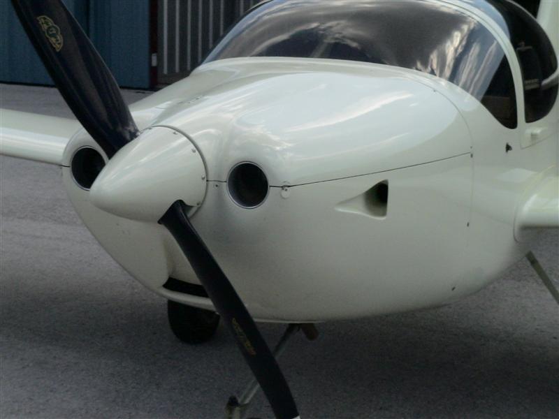

Does the prop sit lower in the fuse on a Jab 3300 installation than on a Rotax?  (I suspect soafter a cursory look at the drawings)
If so, by how much?

I received this from John Wheeler sometime back:
The thrust line on the XS runs parallel to the fuselage datum line,
one and a half (1.5") inches above it.
Is not the fuselage datum line at the door sill? If you study the
attached photo of a Jab installation from Suncoast, it would appear
that the Jab thrust centerline is about the same.
Fred
