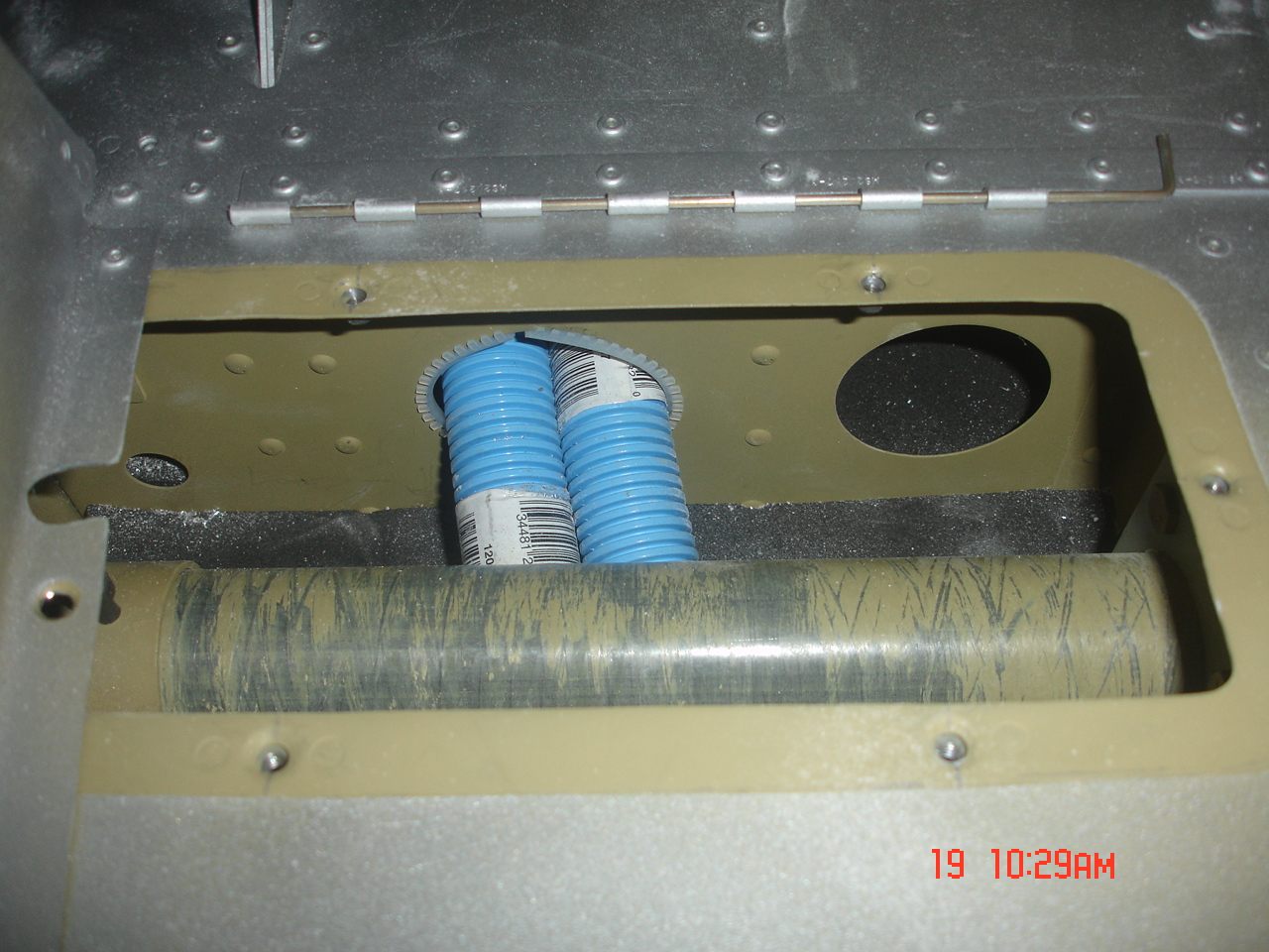

This morning I shot a quick video describing some of my questions regarding abrasion protection of conduit.

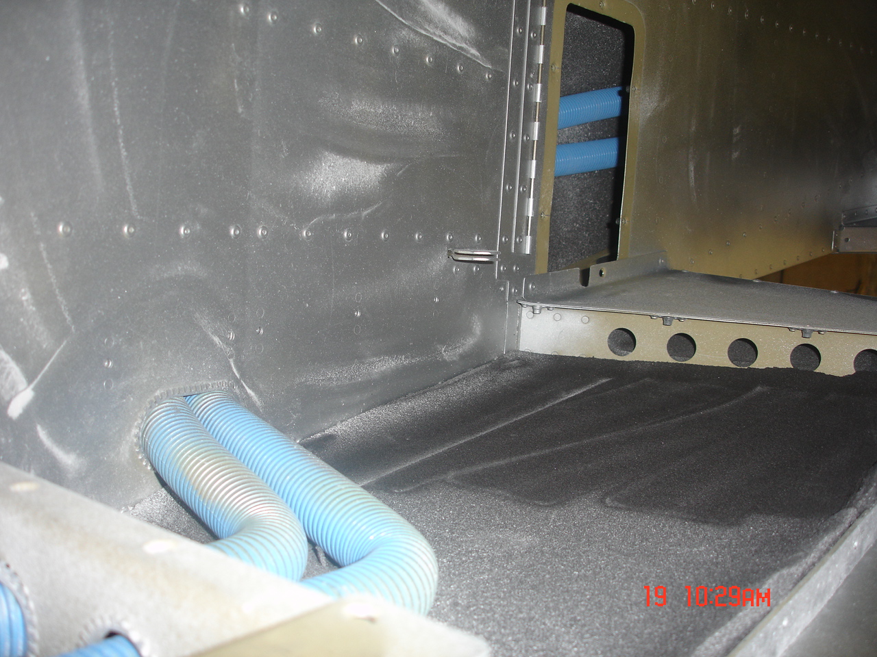

Here are some pics of mine. I did a similar setup but used two on each side instead of three. I cut my holes close tolerance under the seats and wrapped caterpillar grommets around them. The exiting holes are so tight they can't move. I stuffed two lines in one hole wrapped again with the grommet.
Maybe I will abrasion tape around the step where they contact the conduit like you stated.

I'm planning to add the tape to the conduit and not to the step...
As tight as those steps are, I can only imagine how hard it will be to
pull the step and tape through the mount.
Phil

Good point. That would kind of take away the reason to make the plate to
make the step removable.
