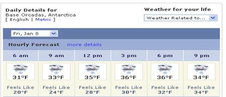

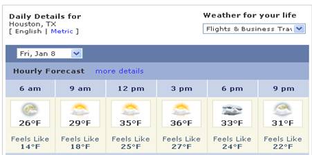

PostPosted: Thu Jan 07, 2010 8:03 pm    Post subject: Can I use this? Reply with quote
Cold in Maine??
Check out tomorrow’s Houston forecast compared to Base Orcadas, Antarctica. J

PostPosted: Thu Jan 07, 2010 9:52 pm    Post subject: Re: Can I use this? Reply with quote
Of course, it's mid-summer in Antarctica. What was Houston like on July 7th?
Bob Turner
RV-10 QB
Phil.Perry(at)netapp.com
PostPosted: Thu Jan 07, 2010 10:07 pm    Post subject: Can I use this? Reply with quote
Lol, yeah. That's what I was telling them at work. It still pretty damn funny though.
