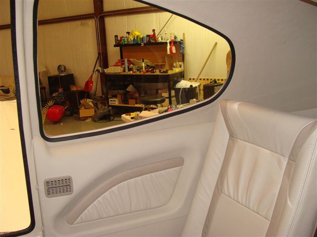

Dave I made my own headliner out of 2 layers of 6oz fiberglass cloth. I
finished the cabin top in the area I wanted the headliner to go to a
Semi smooth finish. I waxed up the cabin top and PVA released it. 2 layers
of 6oz cloth that I trimmed exactly to my window cutouts which were cut and
trimmed to size. Trimmed head liner to size and fit and covered with auto
headliner material. I then put rubber edge trim on window opening. These
Velcro in and work great. I had about 6hrs total in the headliner pieces
from start to finish. They trim out the window really nice. It took longer
to finish the cabin top out then the headliner parts. You still need to do
some finish on the cabin top no matter which way you go.
FWIW Geoff

Geoff, I don't quite understand about the fiberglass cloth but what kind of rubber edge trim did you use? It looks great and seems to match the Mcmaster Carr window seal. Also does your cloth fit under the door seals?
Dave
